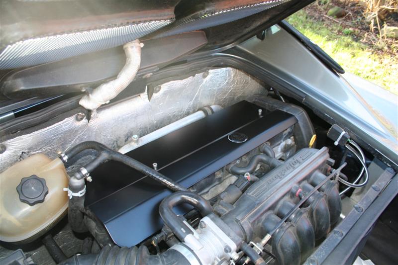

AL G Posted May 13, 2007 Posted May 13, 2007 I made a cover for mine last year ) Works a treat! Took it off for Croft yesterday as thought it may melt, car broke down on the way (fixed it myself by side of the road in the pissing rain - cleaned/sanded contacts inside of dizzy cap_ then put cover back on. It held up fine with the heat, engine cooling is good too as it's very thin ali Common problem mate. You could try high temp siliconing the dizzy back on or an S2 cam cover.

fentuz Posted May 13, 2007 Posted May 13, 2007 I had the same.... before the winter, I changed the leads and the distributor cap.... Went thought winter without any issues.... I like the Idea of your ali custom made cover.... ..... I going to have a thought about it...
