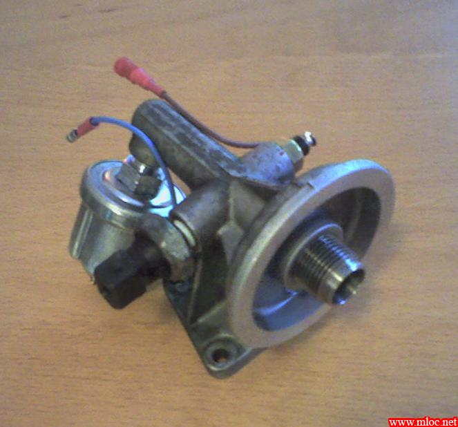

Senders on the oil filter housing
If you are to fit temp sender, pressure sender and pressure switch on the oil filter housing, you really don't have much choice in where to fit what.
The pressure sender will only fit where the oil pressure switch used to be. The switch will not fit on the top location due to lack of clearance.
