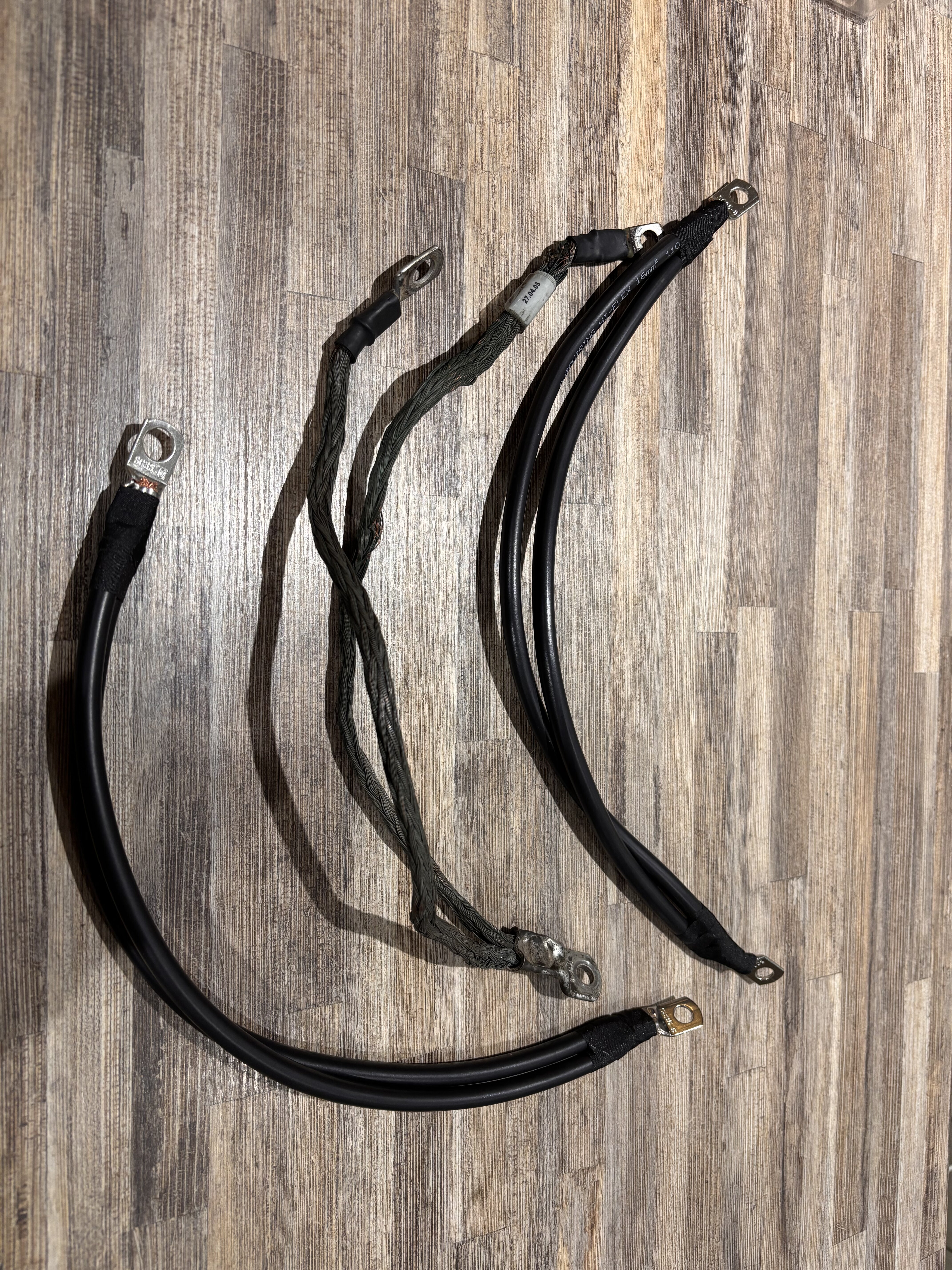

DrSuds Posted February 27 Author Posted February 27 Thanks for the response Andy. It’s the ECUMaster Black series. It’s okay as a bit of kit, nowhere near as slick as the Haltech I have on the S2K. The VVT ground one is external on the loom. Little spade connector that goes to the body of the solenoid (gearbox side unit). The car had one on VVT pulley side, which feels like a Celica hangover. Thanks for the advice on the grounds. In preparation I’ve bought some 16mm2 cabling to add some heavier duty grounds. Car is used for hill climbing, and will be checked regularly for fatigue. I expect the front ground to be difficult looking at the diagrams. I guess that’ll be a clam off job to sort. Quote

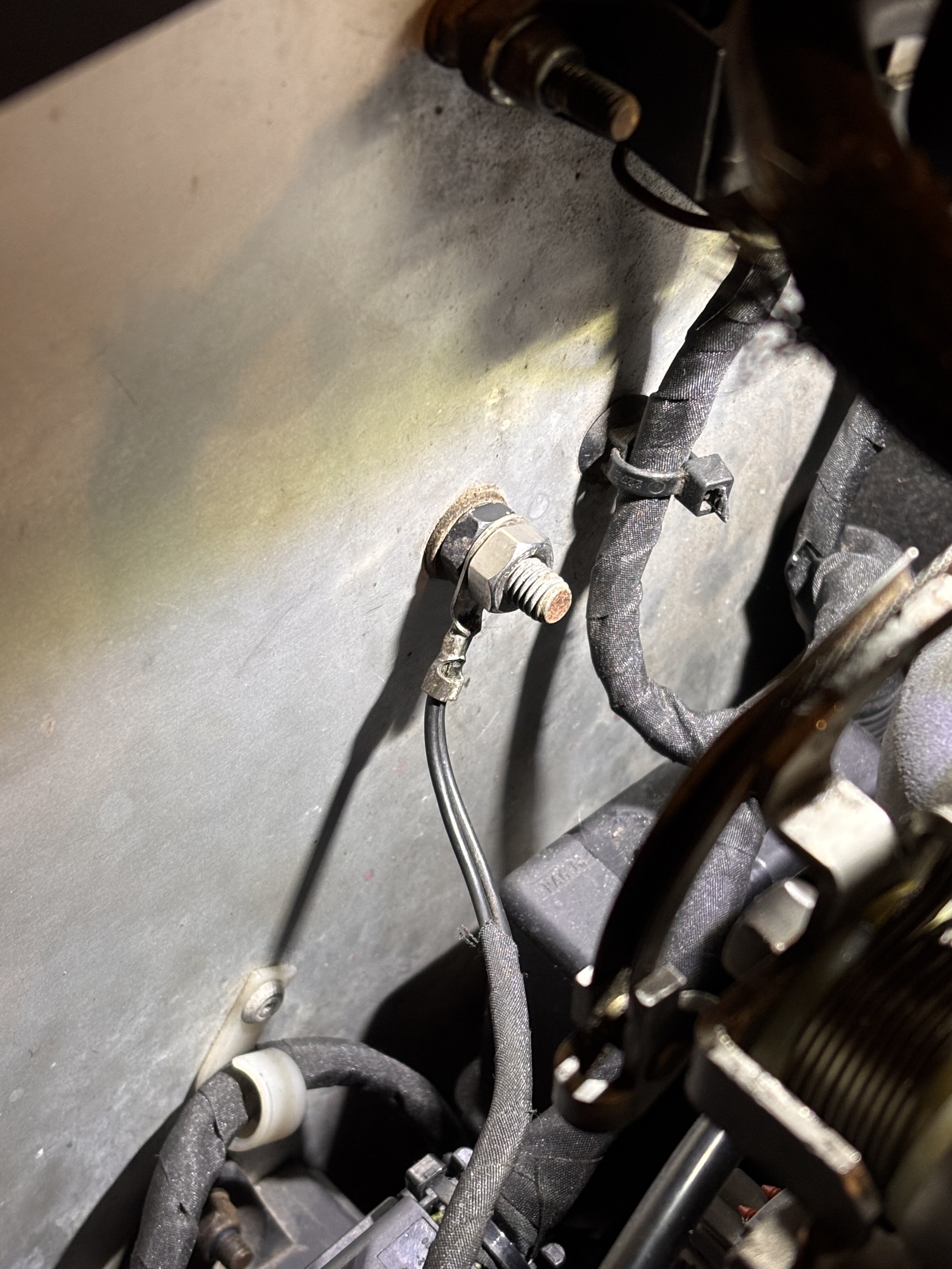

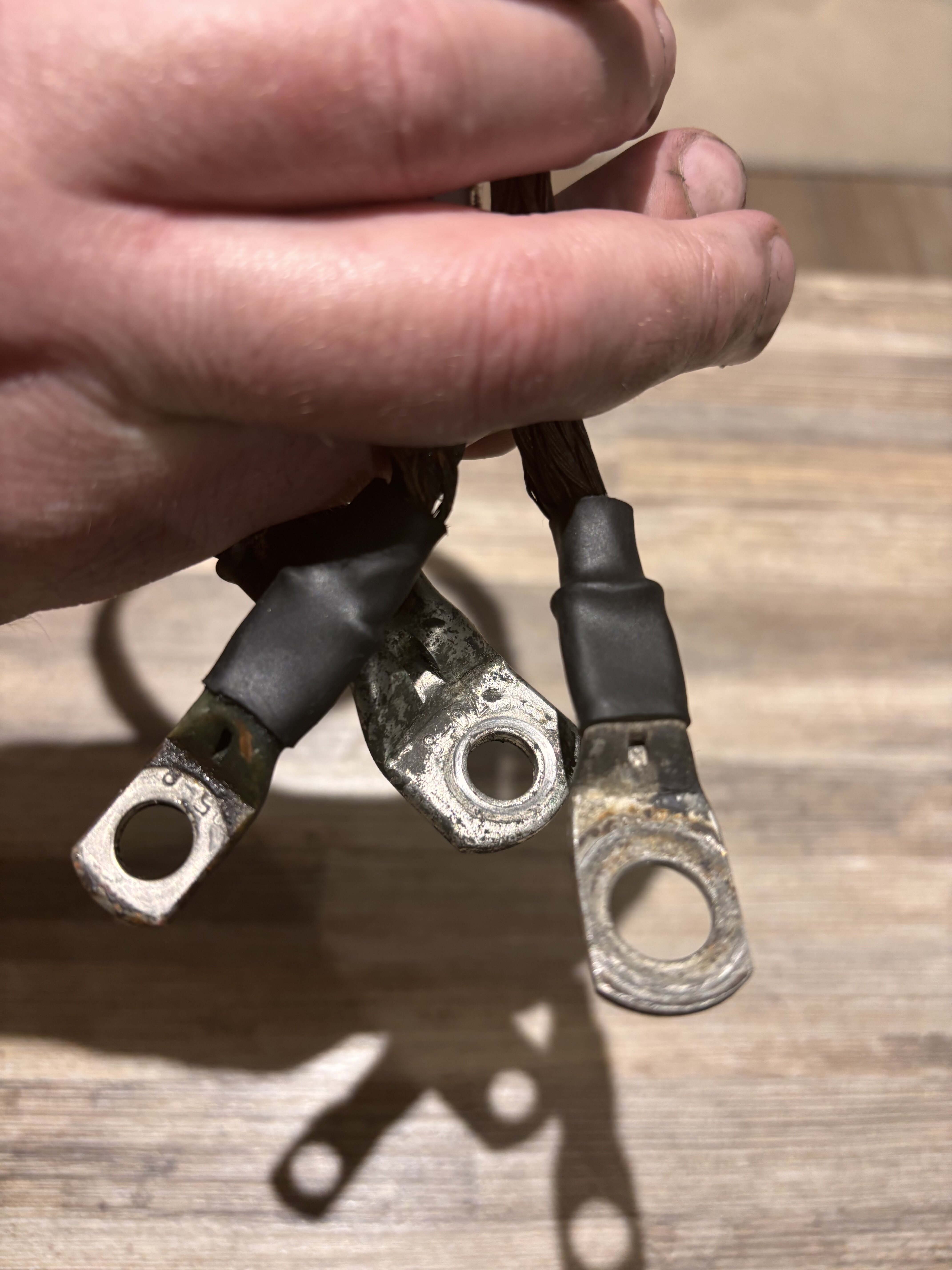

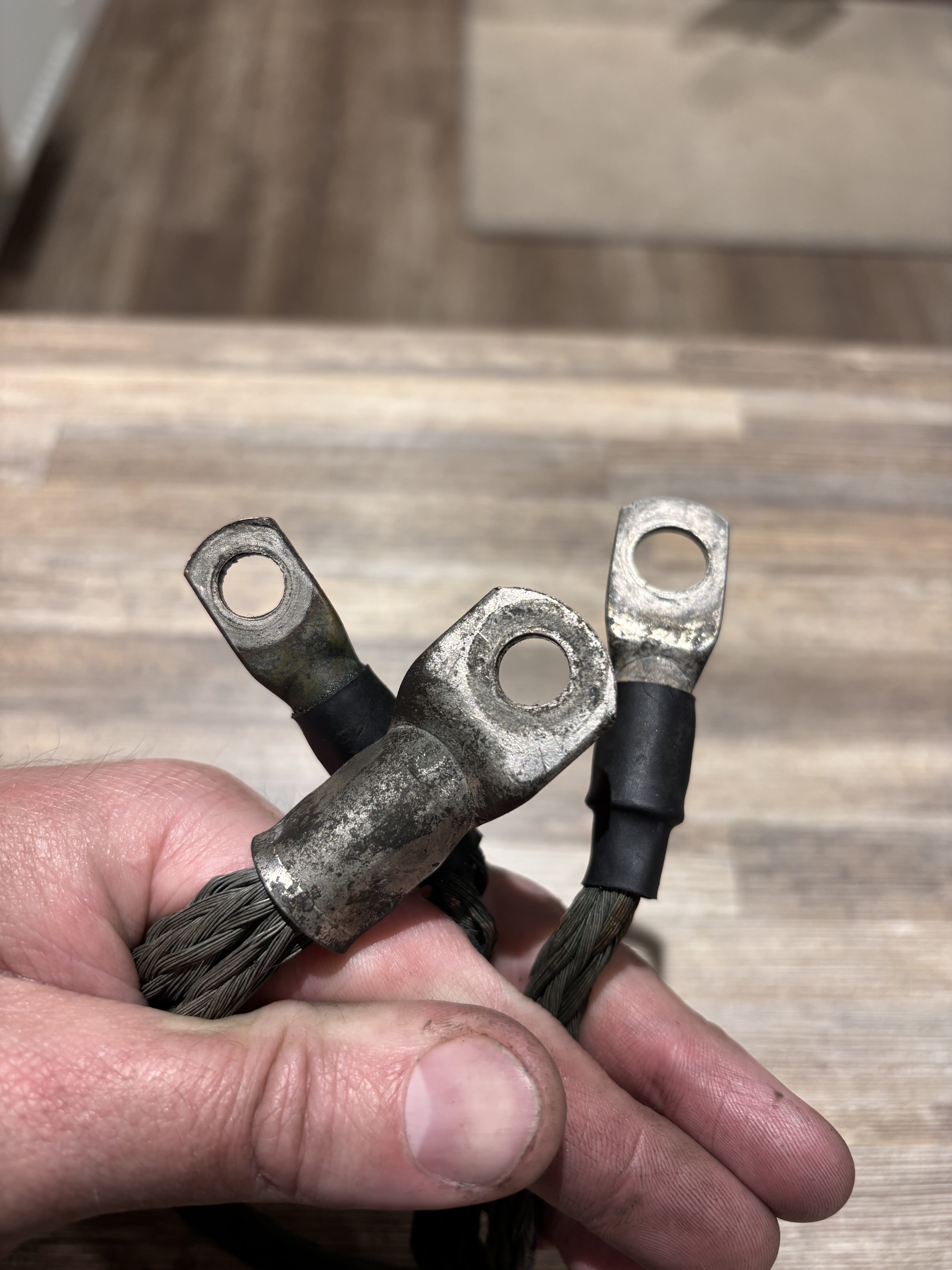

DrSuds Posted February 27 Author Posted February 27 Main ground strap not super pretty. Made up some double 16mm2 lengths to replace. Will re-terminate the battery negative as that doesn’t look amazing either. Noticed there’s a small ring terminal on the effective star point, which goes into the body loom. Not sure what that one references. Will keep y’all posted on progress. Quote

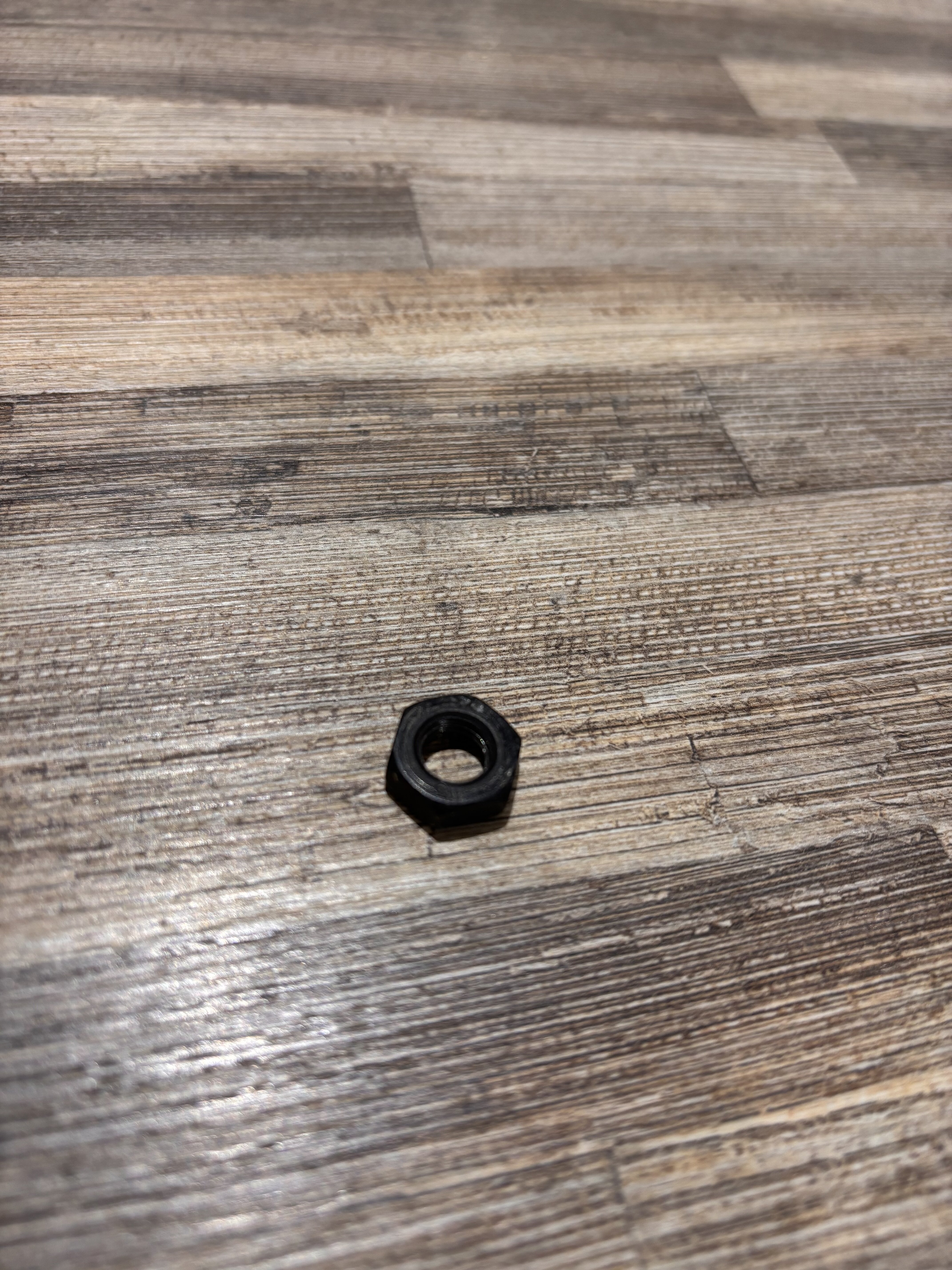

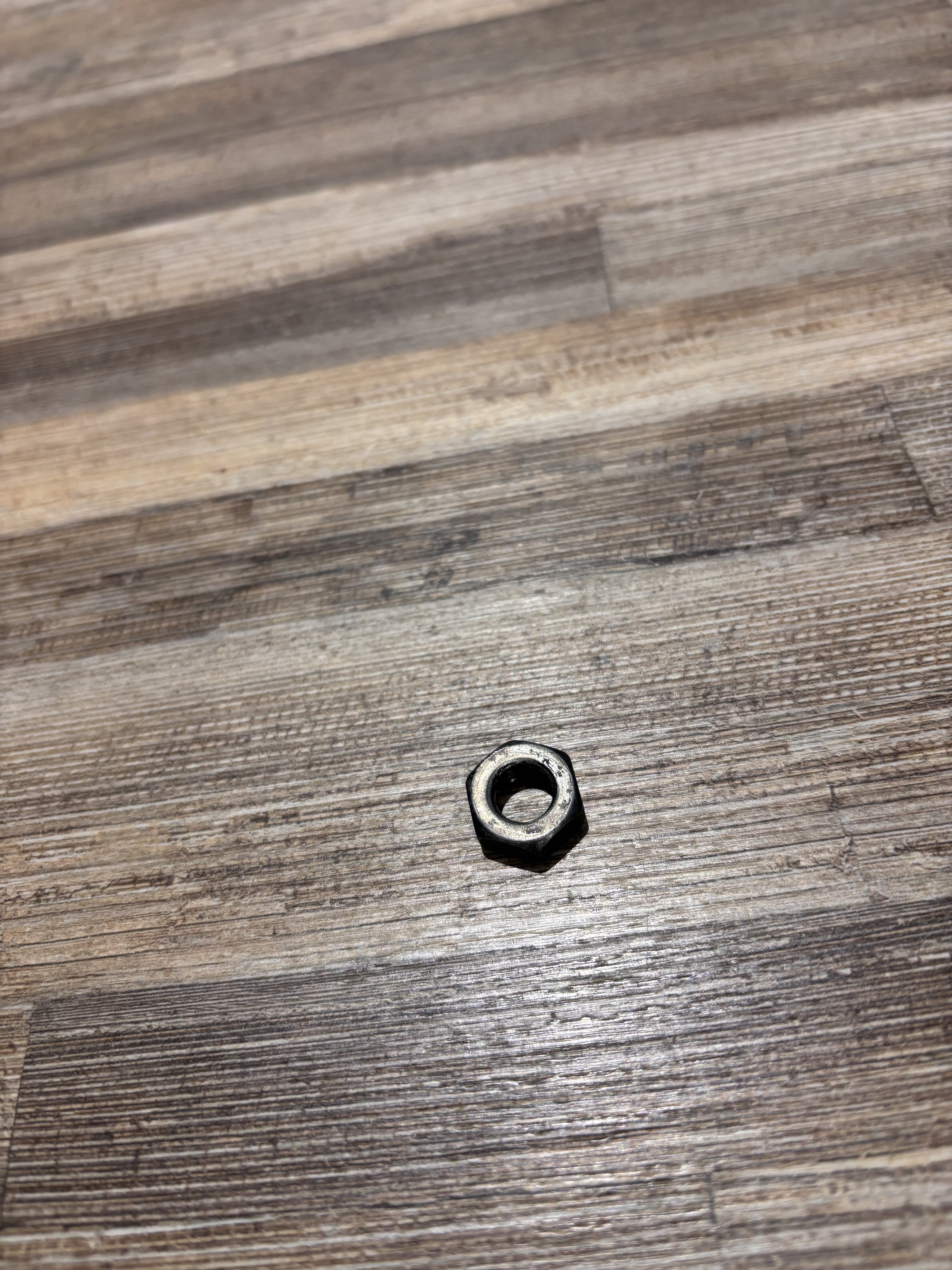

DrSuds Posted February 28 Author Posted February 28 Sweet Louise, here’s a catch boysies. Ground wire from the loom, likely the signal GND, on a double nutted stud. Rear nut on the plate side is painted. Can’t be helping. Quote
Andy wright Posted February 28 Posted February 28 Good photographs.Those grounds are not ideal. They really do need to be clean and bright. A 0.1v Earth offset is more than enough to mess up a throttle pot voltage . Quote
Lithopsian Posted March 1 Posted March 1 For an electrical connection to the chassis, you really want to sand down the contact patch to remove any anodising. The S1 uses a special stepped alloy washer, over a non-flush rivnut, so that the ring terminals make good contact with the chassis. Connecting through a nut probably isn't great even if it is clean steel. Maybe the stud has good electrical contact already, but who knows? Quote
DrSuds Posted March 2 Author Posted March 2 I cleaned the studs with brake cleaner, wire brush, red scotch brite and finished with electrical contact cleaner. I also used an anti-shake washer as semi cutting tool to cut the surface back between cleaning. Likely as good as they can be. Reassembled the grounds with new ground straps with fresh nuts and anti-shake washers. Car started and runs without issue, TPS was stable throughout. Will need a bit more time to confirm all is well. Appreciate the feedback chaps. Quote
