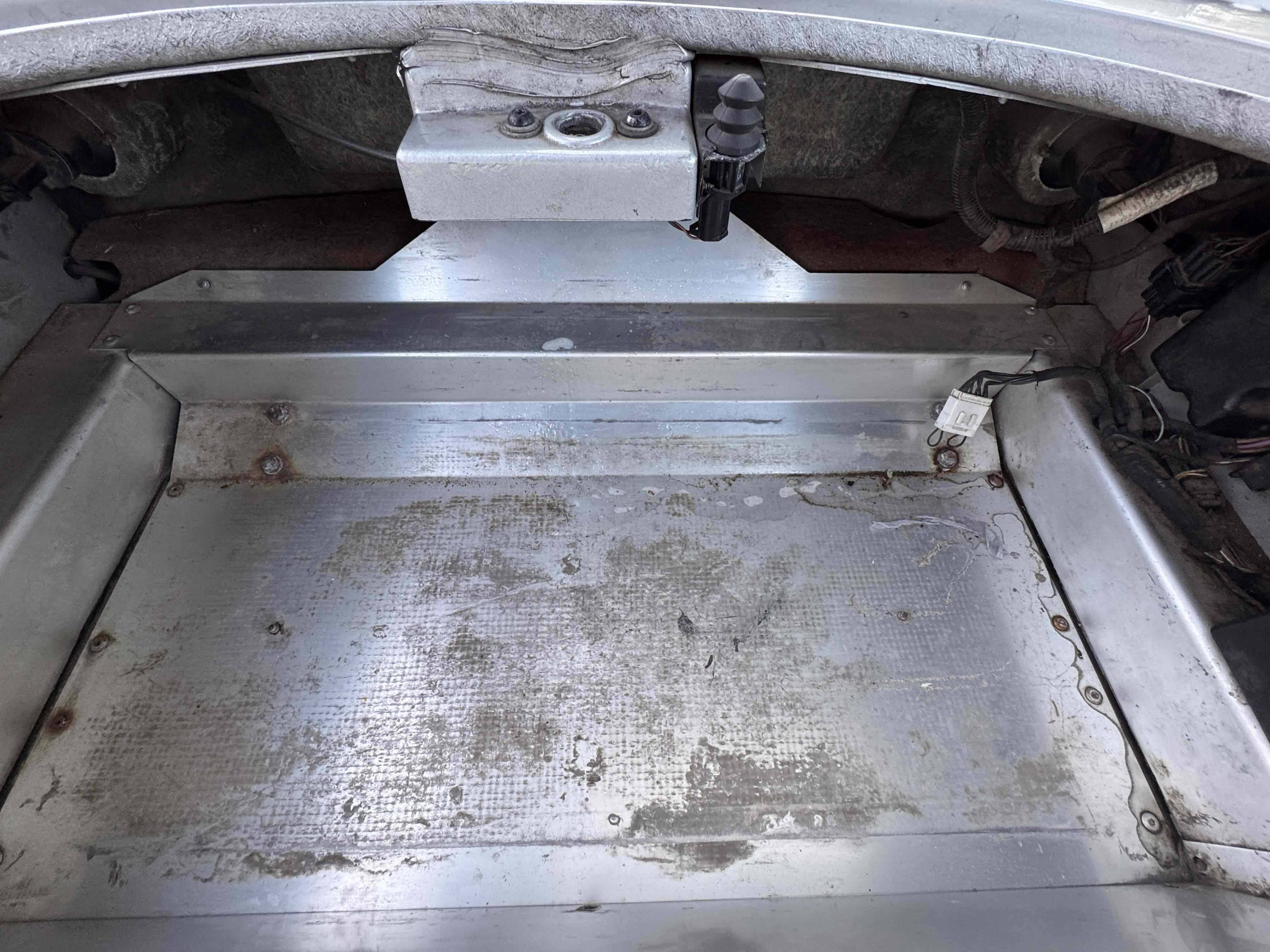

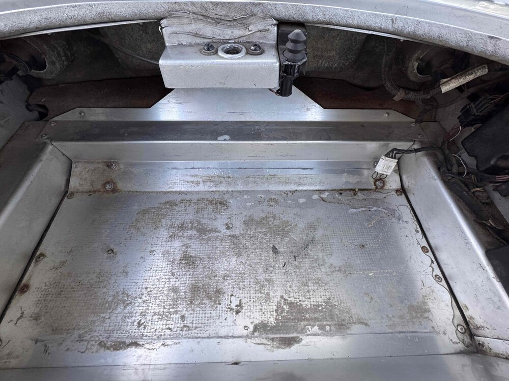

binsk Posted August 20, 2025 Posted August 20, 2025 First post, owned a 1997 S1 since January. This site ("Wet Boot", topic now closed) tells me these S1s sometimes came fitted with drain pipes in the boot, fitted to the round drainage hole in the boot gutter. Mine just floods because it's got no drain pipe and, crucially, I can't figure out the correct exit route for a bodge-job pipe. Could anyone share a photo of the proper drainage pipe in situ? Much appreciated! Quote
Lithopsian Posted August 20, 2025 Posted August 20, 2025 I know where it goes on a bootbox car, but suspect you have a bootbag? I think it still goes to the drivers side wheel arch, presumably clipped to something? Quote

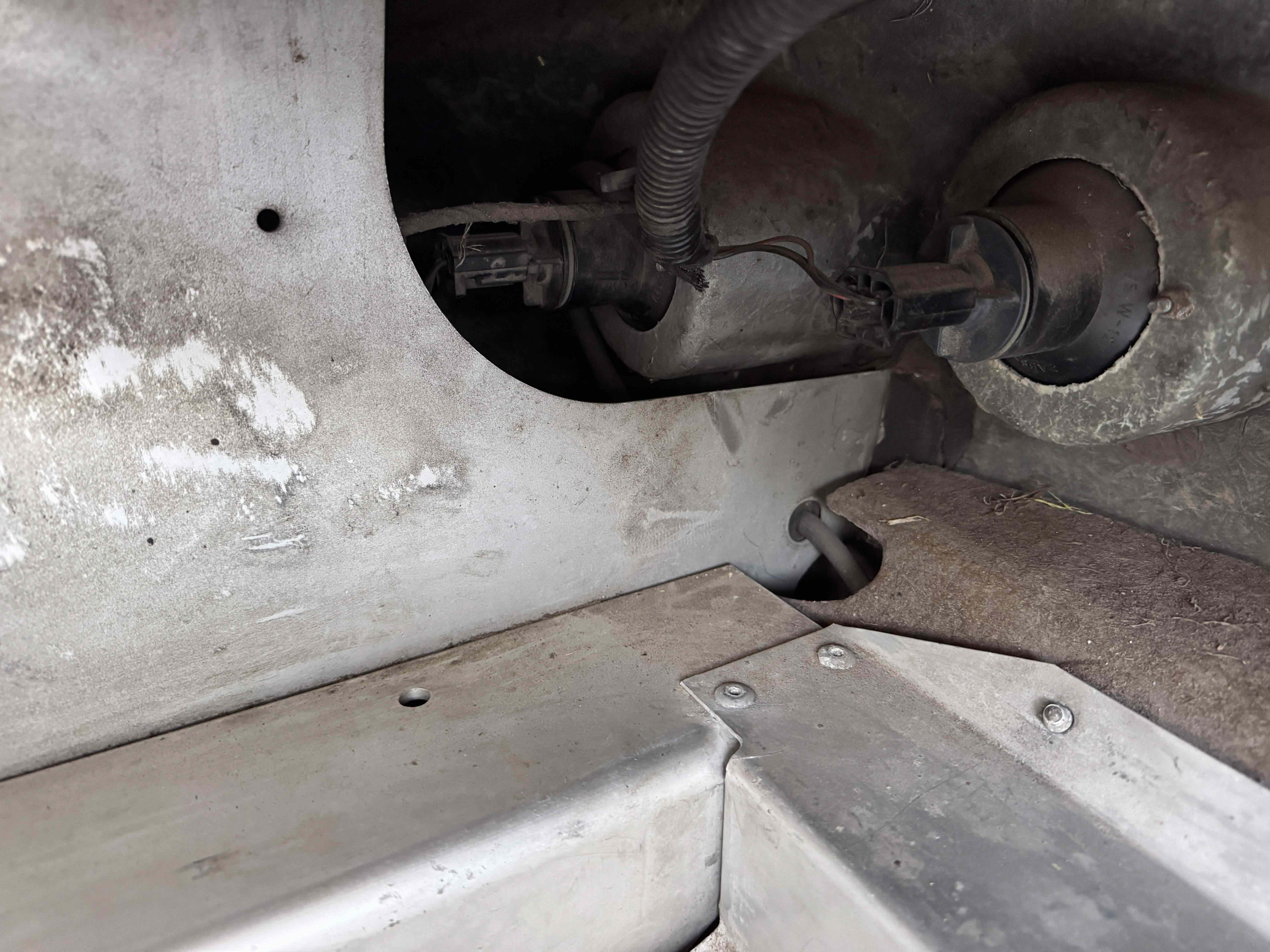

Jonathan E Posted August 21, 2025 Posted August 21, 2025 98 S1 it went through the floor below where the right hand indicator is. Washing machine fill pipe is a good fit onto the boot drain👍 Quote

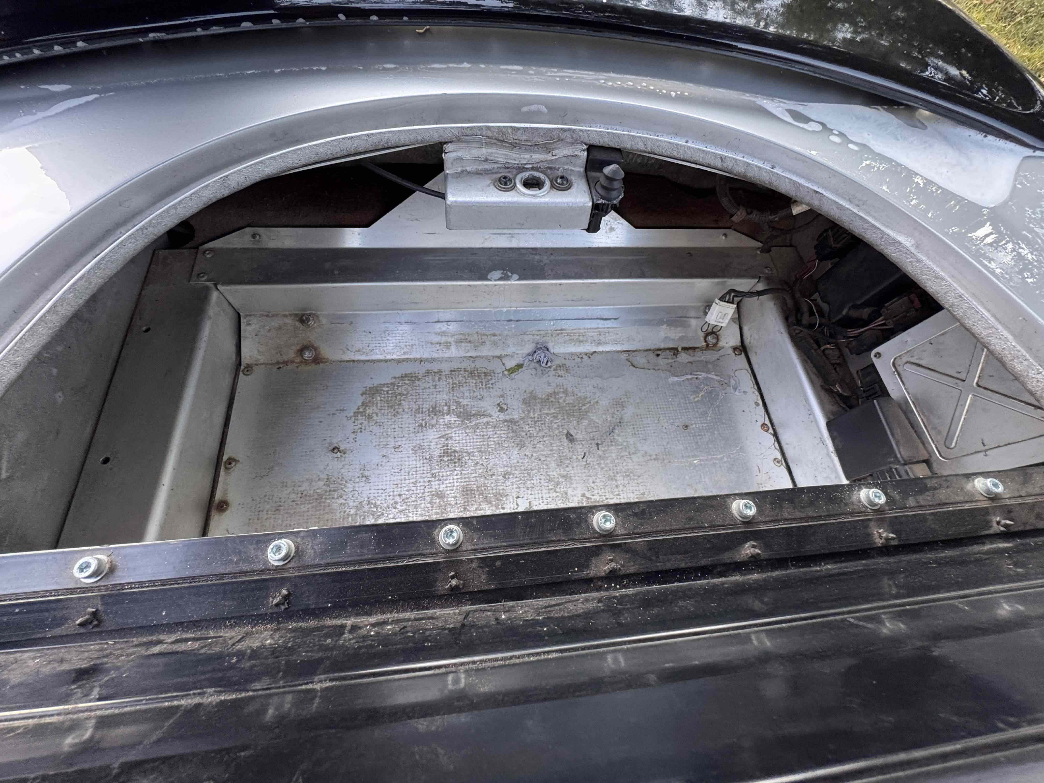

binsk Posted August 22, 2025 Author Posted August 22, 2025 Many thanks Lithopsian and Jonathan E for the quick replies. I'll go ahead and bodge something that goes out under the rear right indicator. Just for completion I'm attaching three pictures. I'm presuming this is a "bootbag" kind of boot, just bare riveted aluminium. Here's to a dry Autumn! Quote

Lithopsian Posted August 22, 2025 Posted August 22, 2025 No bag? On this type of boot, there should be a rectangular bag about the size of the alloy plate. It is a bit of a make-shift solution to not having a solid formed boot, but better than stuff rolling out into the wheel arches or worse. Quote
binsk Posted August 28, 2025 Author Posted August 28, 2025 Oh yes, you're right, the seller did include a large bag with the folding roof parts in it. I thought it was just the "official roof bag" and didn't know it was technically a boot-bag so I've been keeping it in the garage. It can go back in the boot now where it belongs. Thanks for the info. Quote
