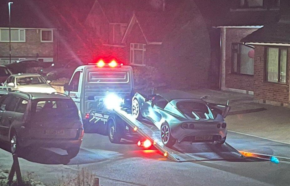

foxy76 Posted August 11, 2025 Posted August 11, 2025 Been out for a drive tonight, all fine. Stopped to fill up, went to set off, nothing happened. Red light stopped flashing as it should when I pressed the key fob. Turned the key, hear the fuel pump prime, all dash lights are fine, but nothing from the starter. Checked the inertia switch (just in case, but I know the fuel pump wouldn't have primed if that was the issue). Sat waiting for breakdown, but does anyone have any ideas? Quote

foxy76 Posted August 12, 2025 Author Posted August 12, 2025 I'll give that a try, but the breakdown guy seemed to think that the starter wasn't even being tried. It was very late so you could hear everything, or not in this case 😞 I've seen a bit about problems with the starter motor relay, so I'll have a look at that as well. Not the end to the night I was hoping for 1 Quote
