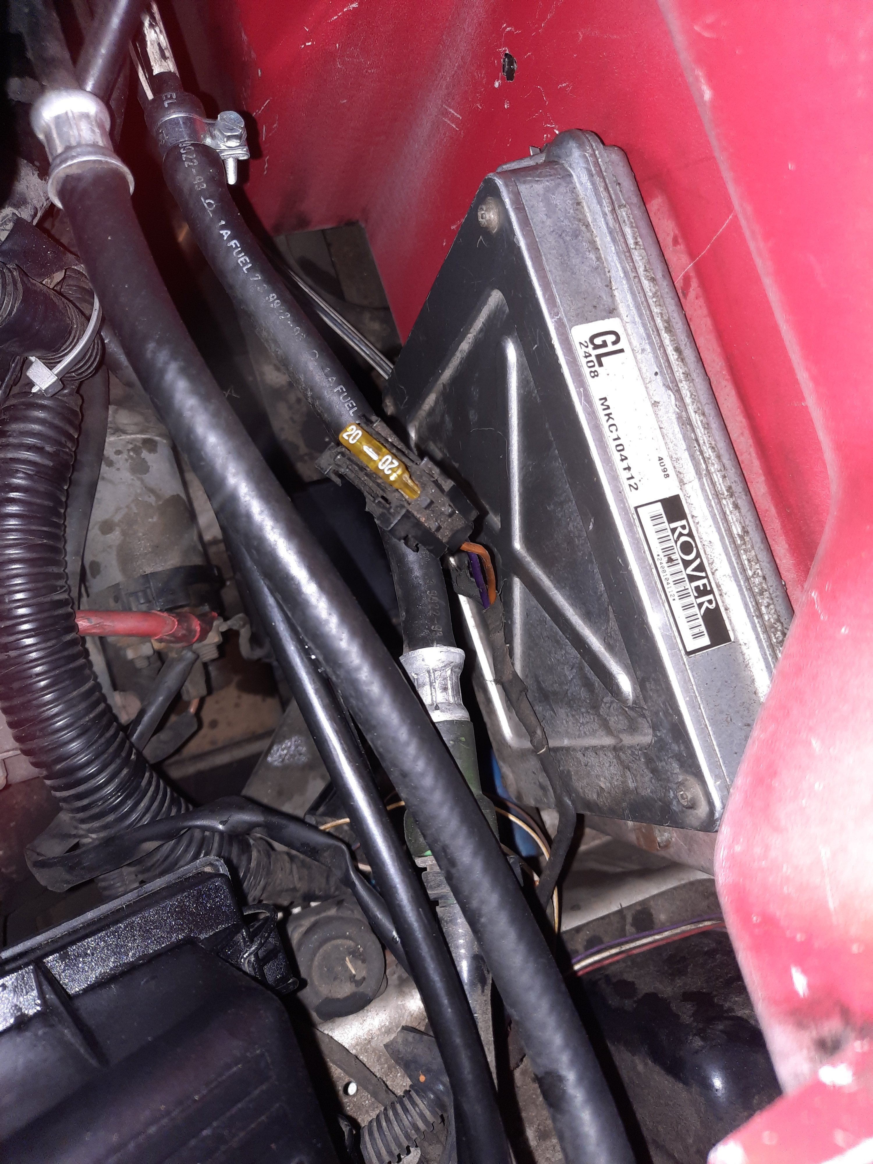

Hi, did a fuel filter change on my S1 elise a few days ago, all good, only had it a couple of months.
The manual says to disconnect the fuel pump fuse, then crank engine to depressurise the fuel system.
After hunting for this 20 A fuse, I eventually found it hanging loose, and bears little relation to where the owners manual or service manual says it should be (even these 2 documents contradict themselves)
Any idea where it is supposed to be located ?

They have been know to corrode and melt the holder which is what is suspect has happened with yours looking at the picture? That looks like it has been replaced looking at the heat shrink. On some S1,s it was next to the ECU also in the picture?
