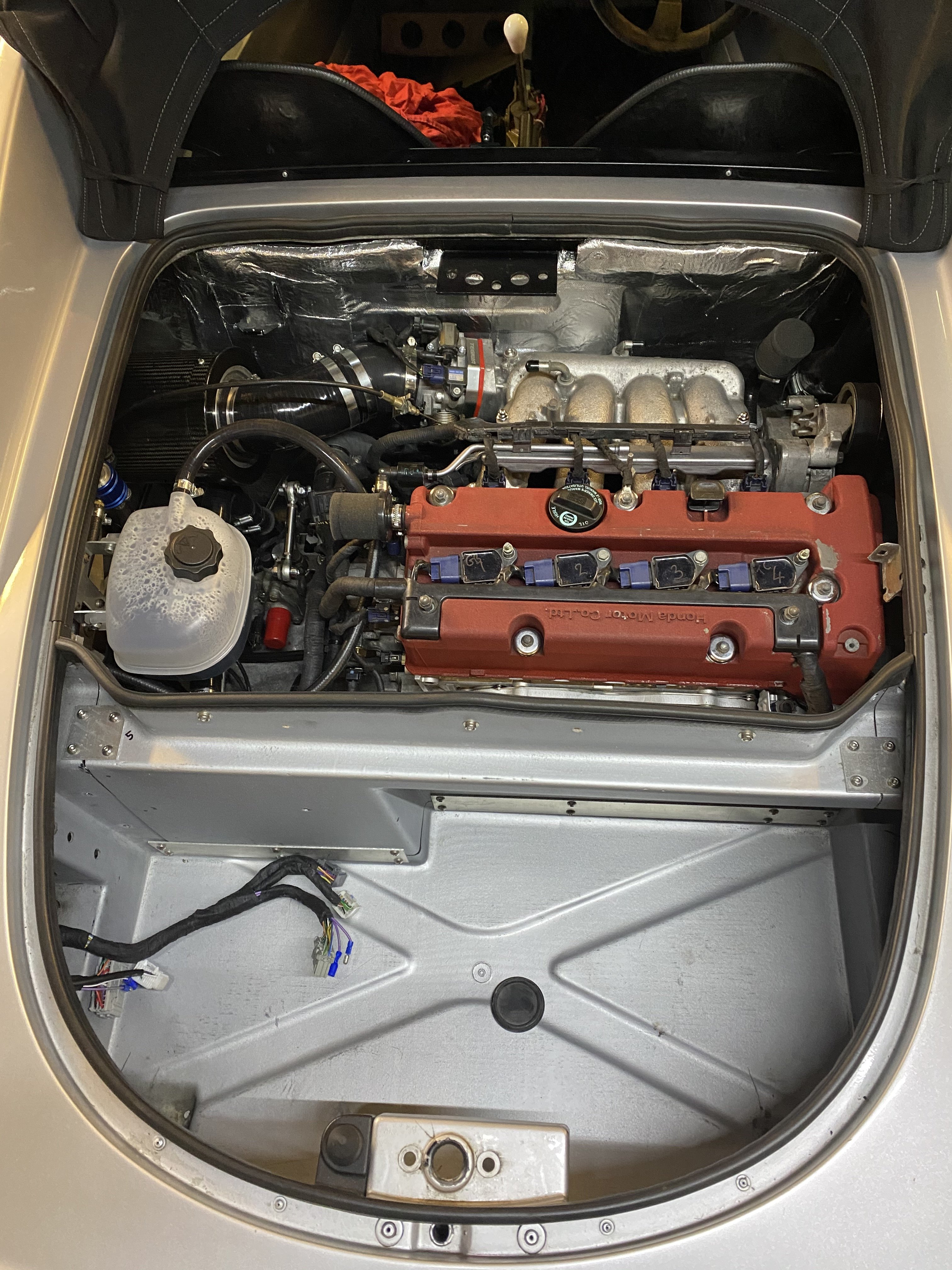

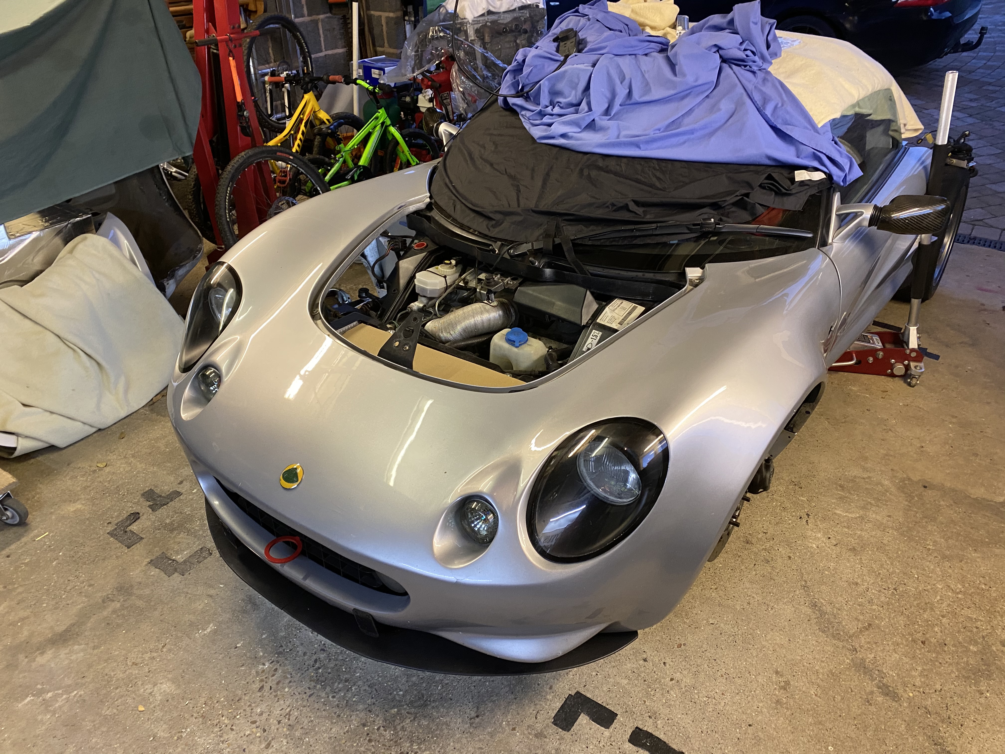

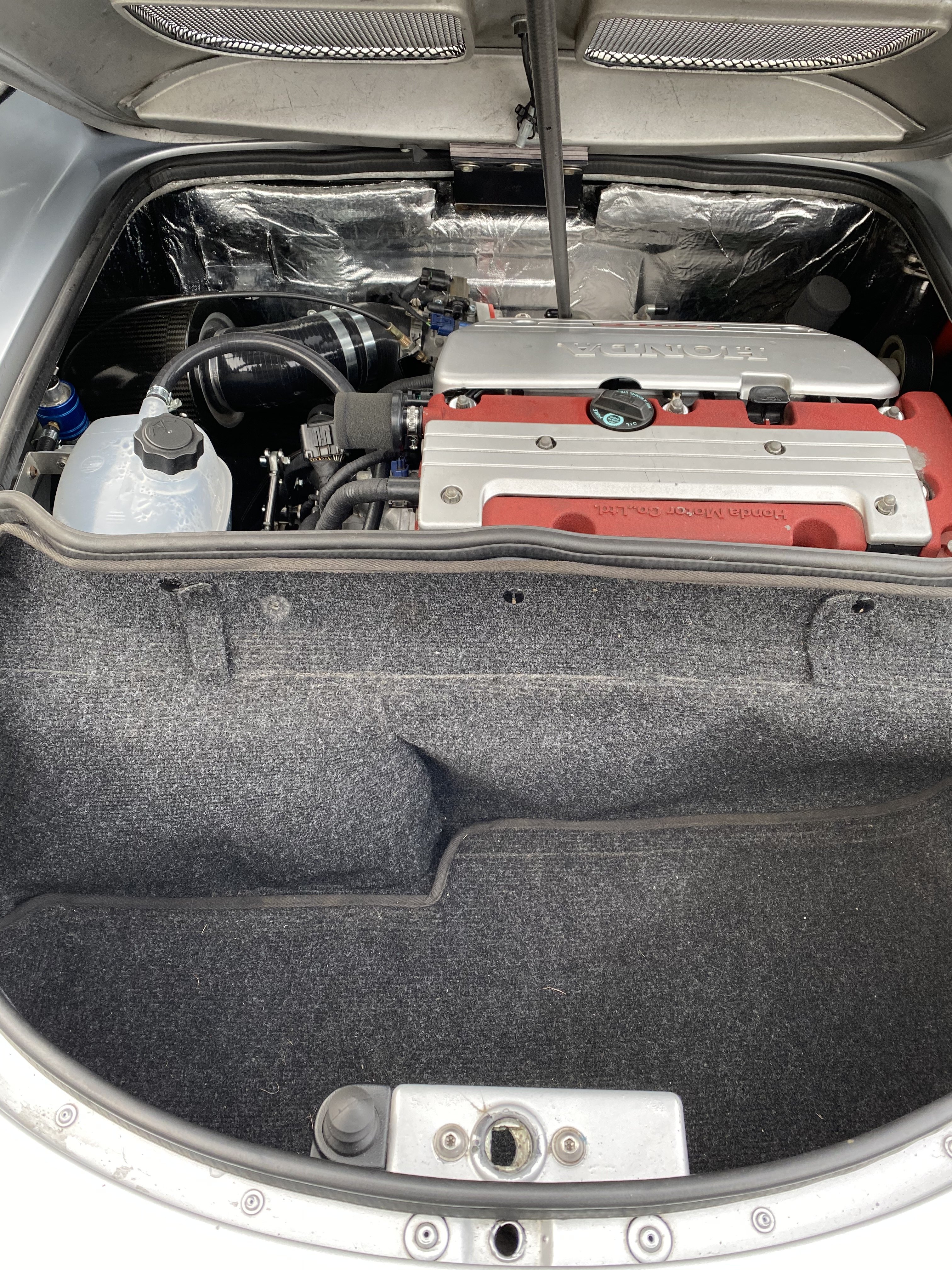

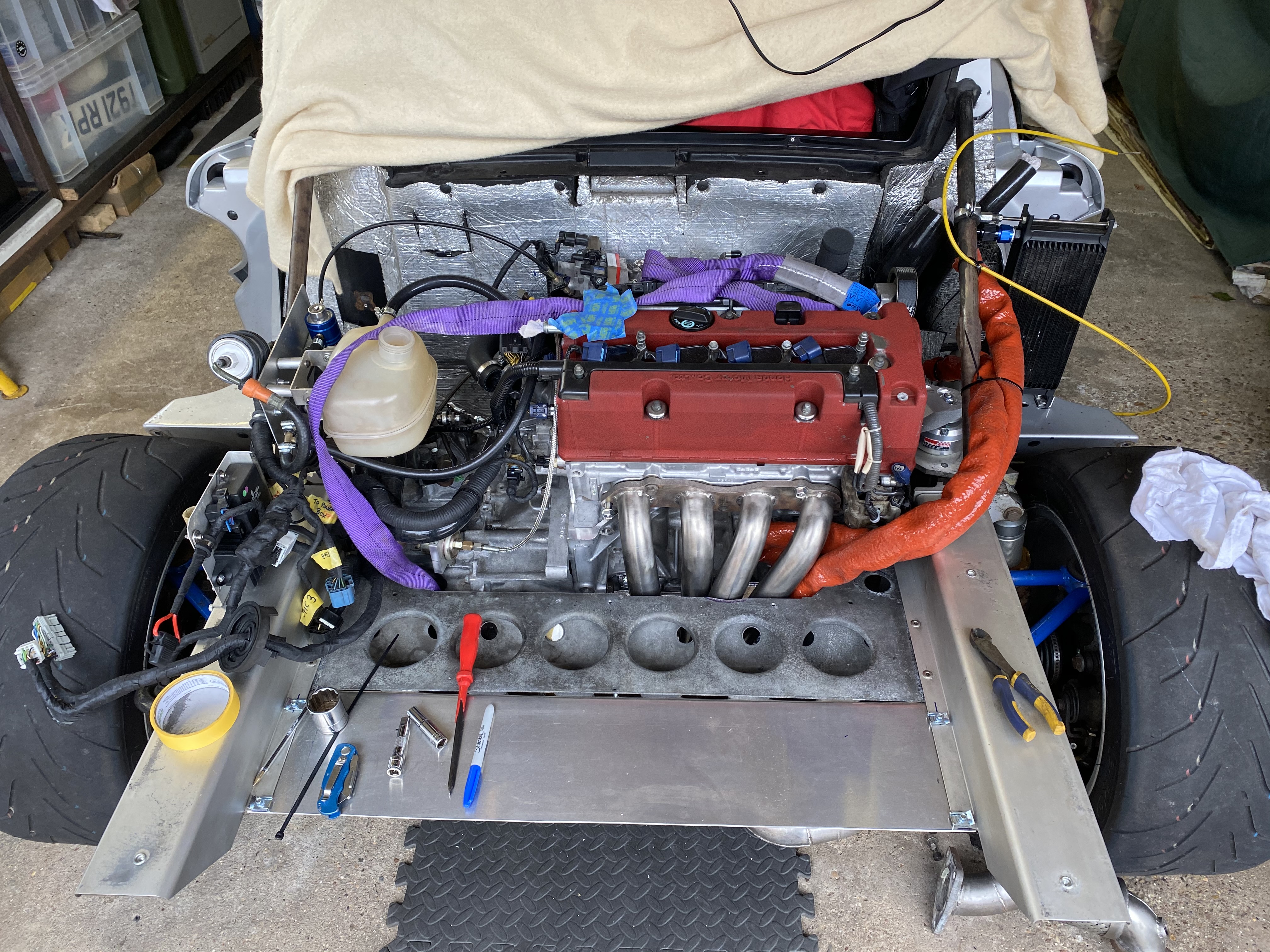

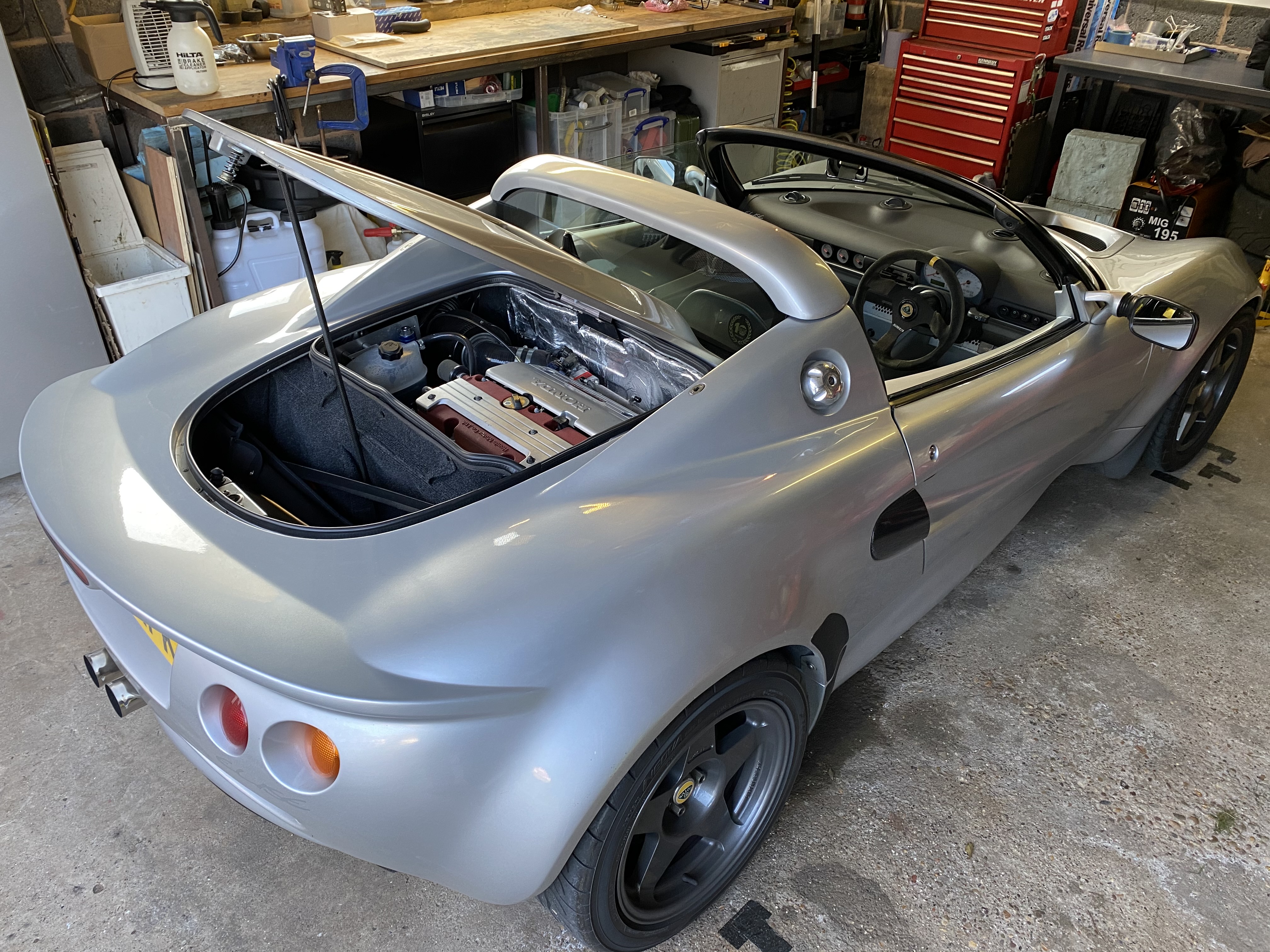

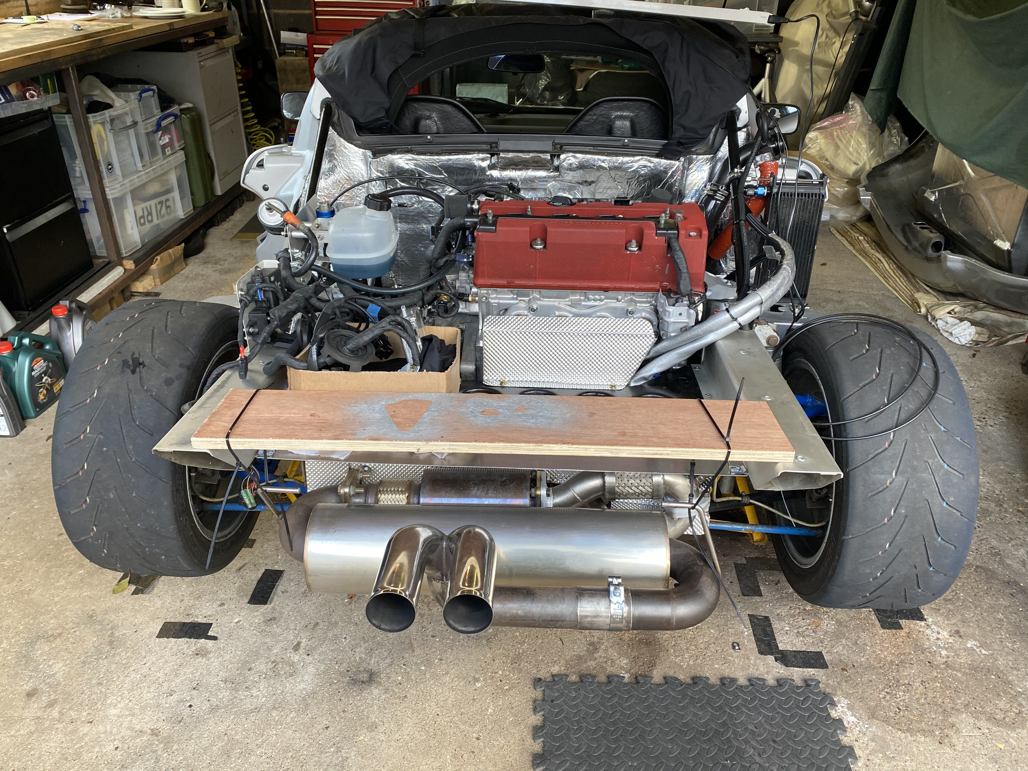

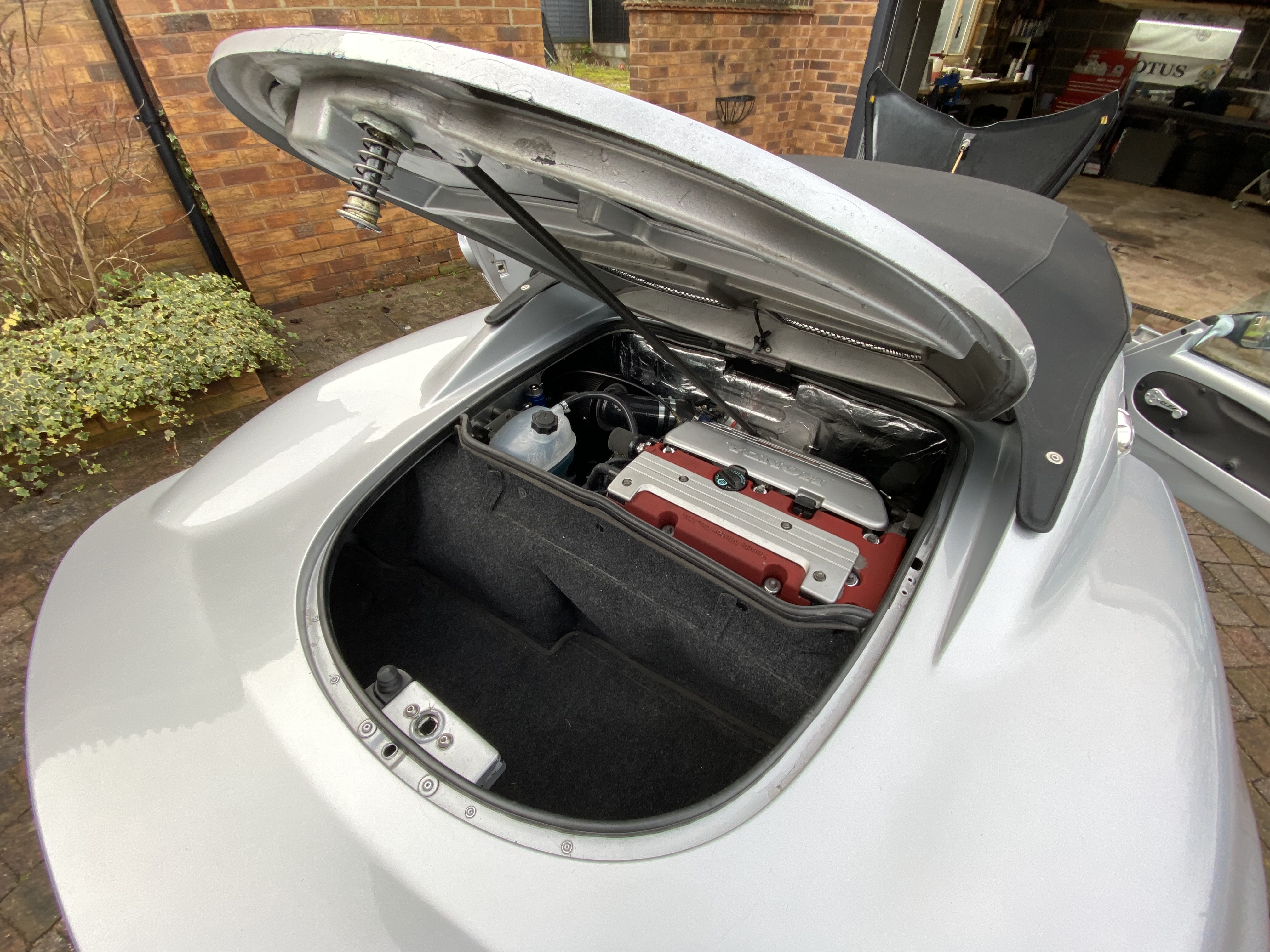

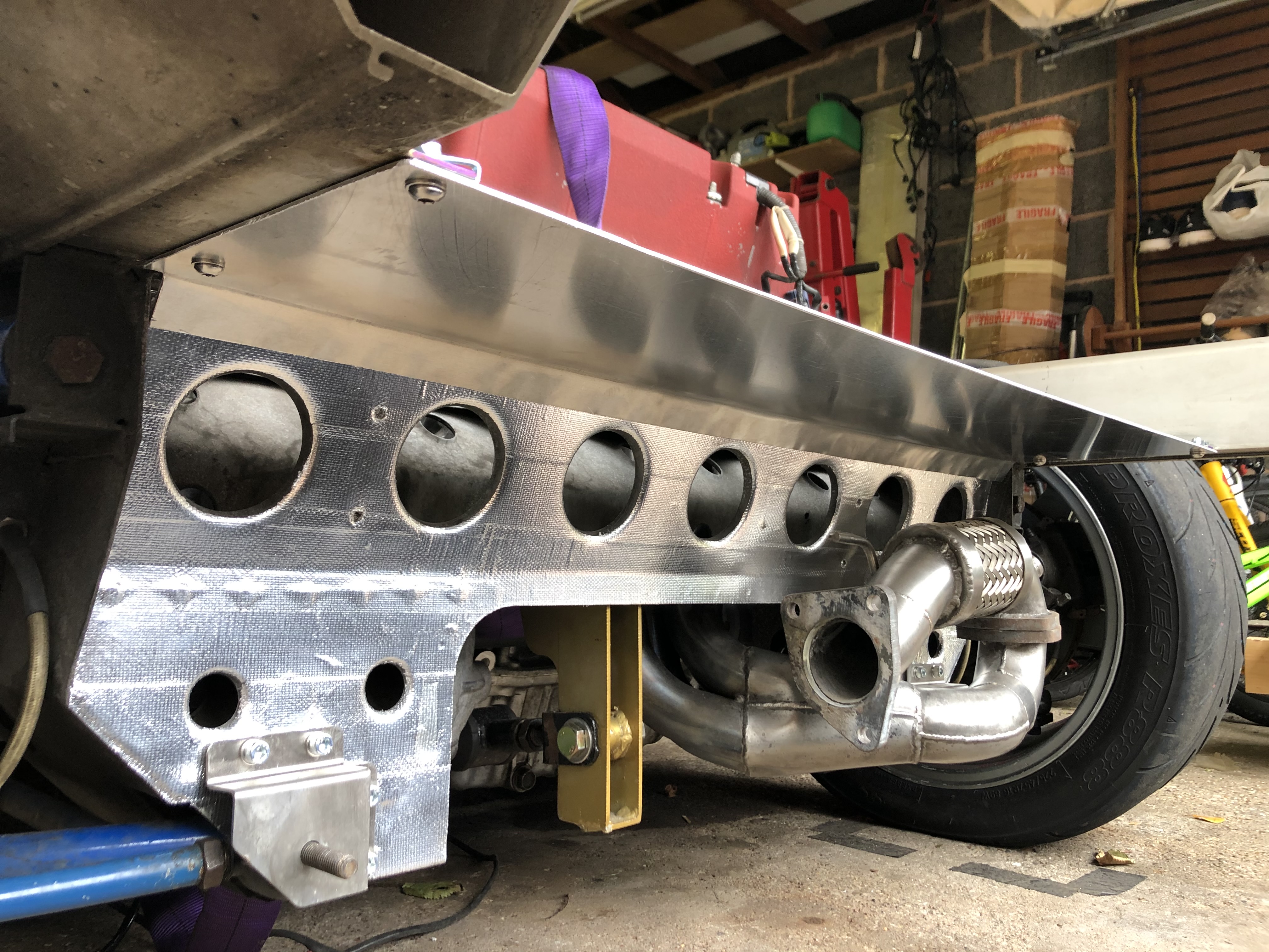

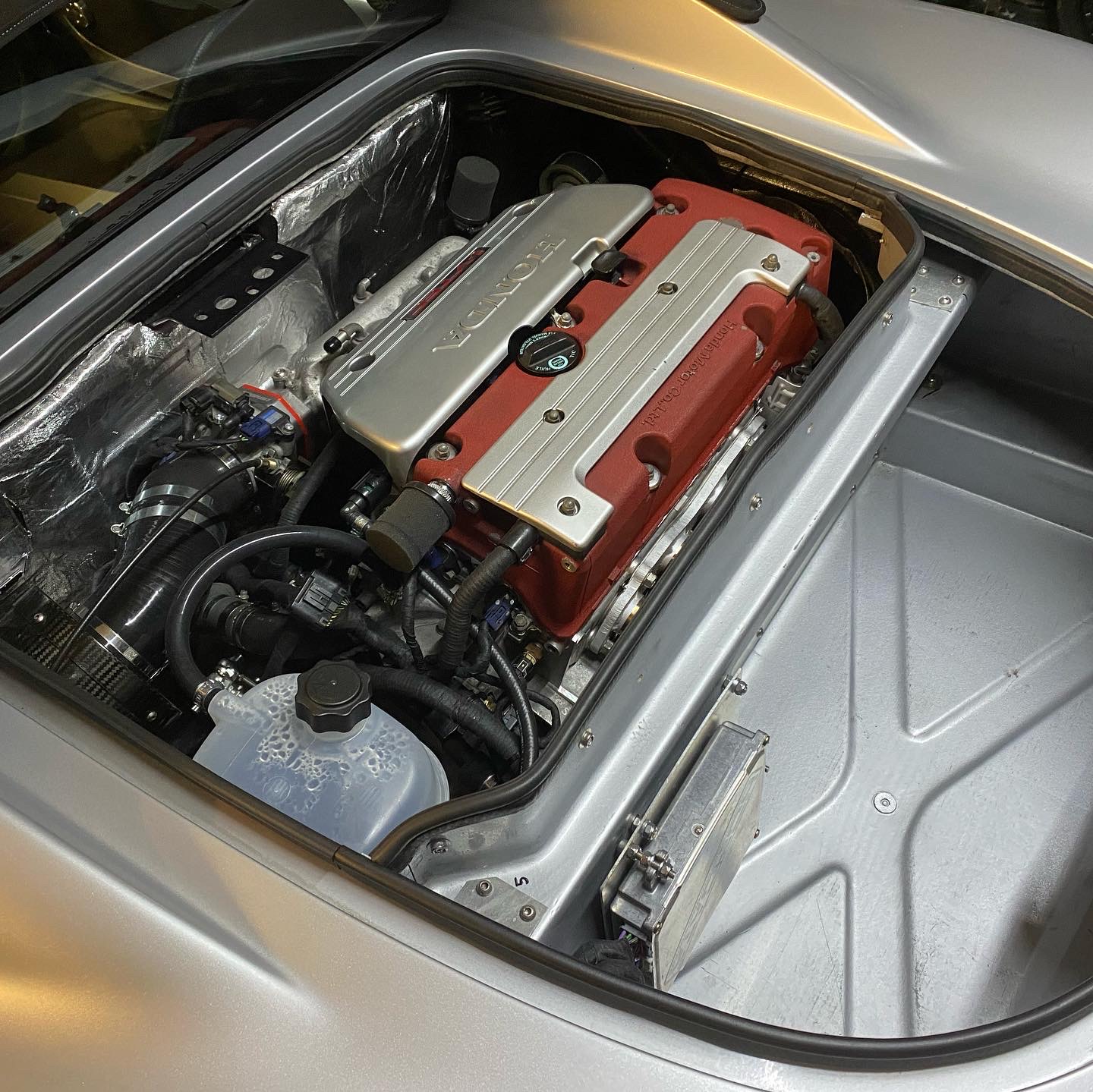

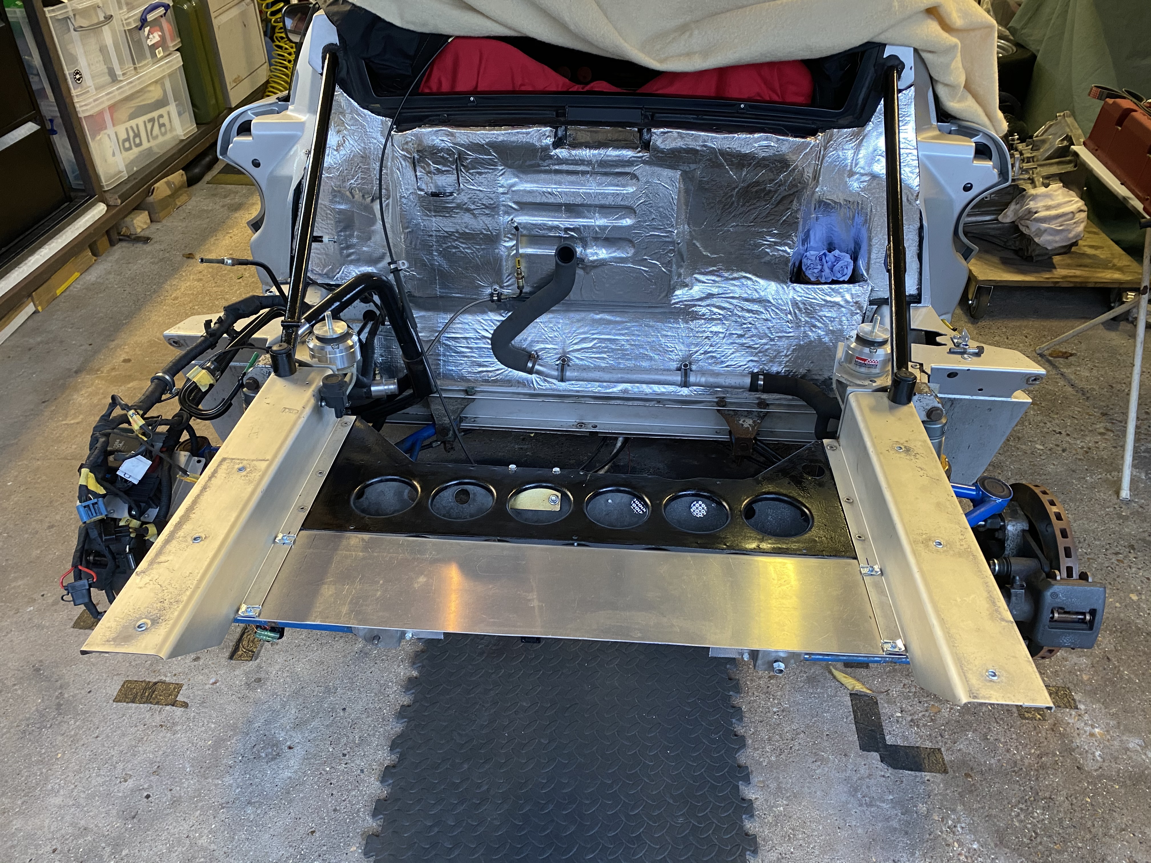

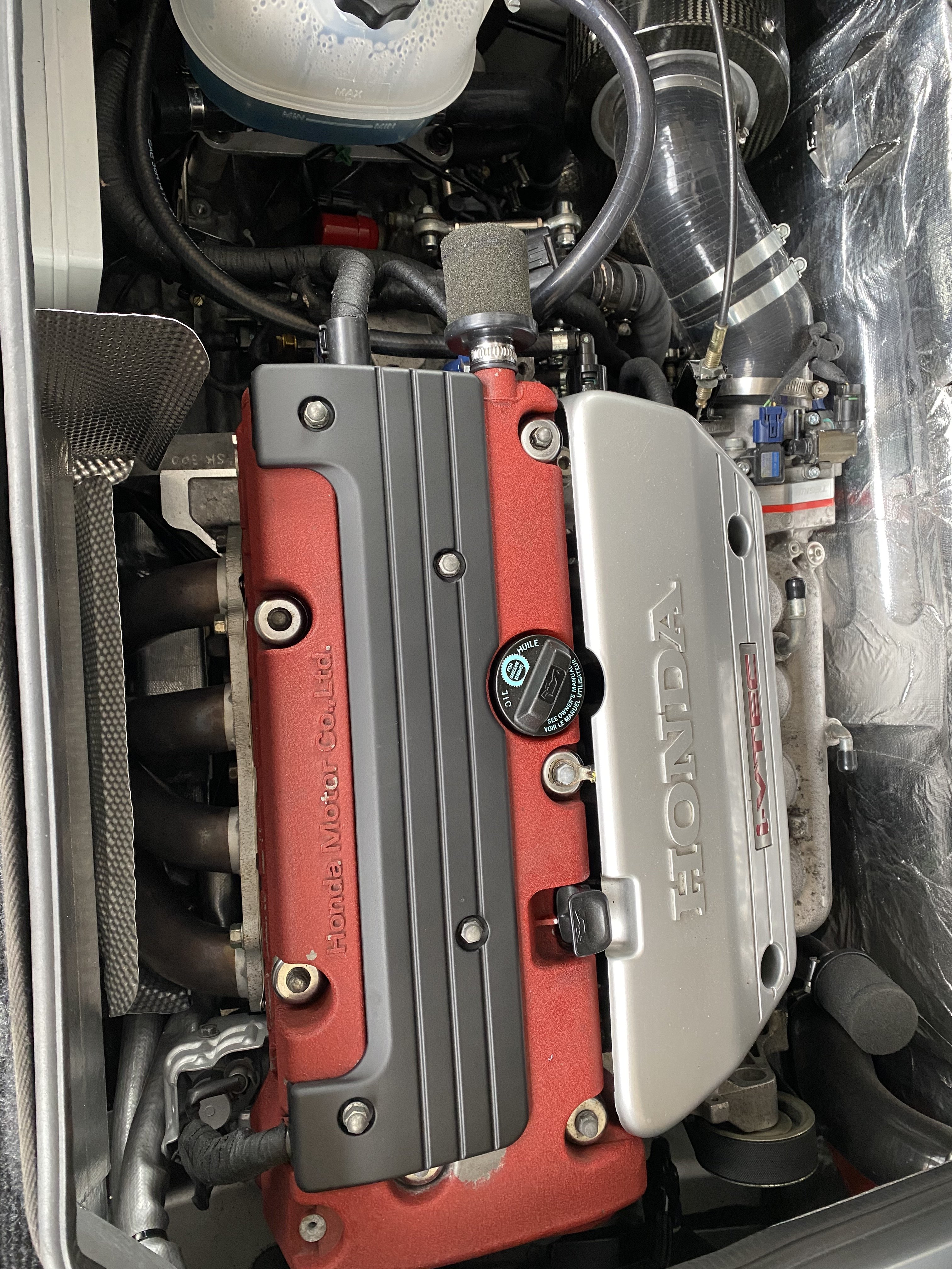

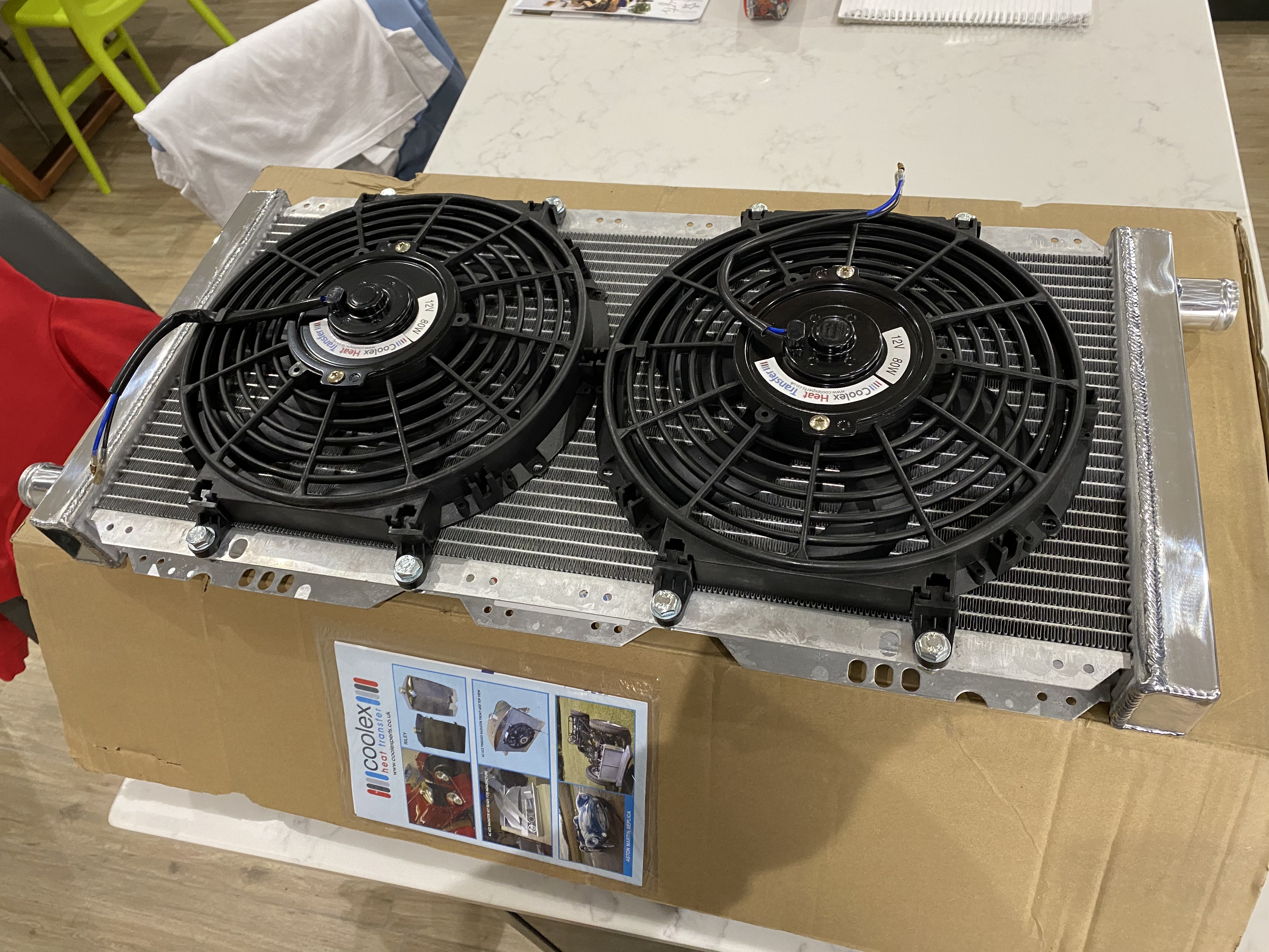

jody391 Posted April 3, 2021 Share Posted April 3, 2021 Its been awhile since being on here! and I haven't seen a lot of you in blooming ages1 Back in March last year I decided to bite the bullet and go head first into an engine swap in my S1, Covid helped this somewhat by stopping my boys football/rugby training and matches giving me week day nights and weekends. First I needed to source an engine, after Alan and Alex having there cars to ponder over I was initially looking at a K20A2 EP3 engine, but finding one under 100k was near on impossible unless it was re built and costing a small fortune! So I decided to look at the slightly newer FN2 K20 Z4 engine, having read up the differences in the engines some were none issues and some where going to cause some headaches! I finally found what looked like a good engine at a breakers who specialised in engines, having spoken to them the purchase was completed along with gearbox and drive shafts on a quite low mileage of 70k, this was also the mileage of my car1 so it seemed fitting. Jumping some months and some headaches and the engine was fitted and 150 ish miles were put on the car checking the fit/mounts and the general install. Dan @ HPE sorted me a slot for mapping which was the final piece of the puzzle so a date was set and arranged. The day of the mapping was somewhat of a roller coaster as 20 mins into the mapping session a huge plum of smoke appeared and que me shouting Dan to kill the engine as we also now had fire!! my heart sank but the fire quickly stopped as Dan switched the ignition off! An oil pressure gauge sender extension line had got to hot and a small pinhole was firing oil onto the hot manifold!!! Luckily Dan had some blank plugs and I after a few hours had the blank plug in so we could still finish the mapping the same day. Final figures: 218bhp and 159lbft of torque! que my rather large smile at the time seeing all the hard work and head aches come together! All I an say is as others have said before WOW the engine is what the car should of had in the first place! boy do they f@&king go! and the noise is immense! I can not recommend the swap enough! Some during and after images, hoping to get out to some meets soon! Link to comment Share on other sites More sharing options...

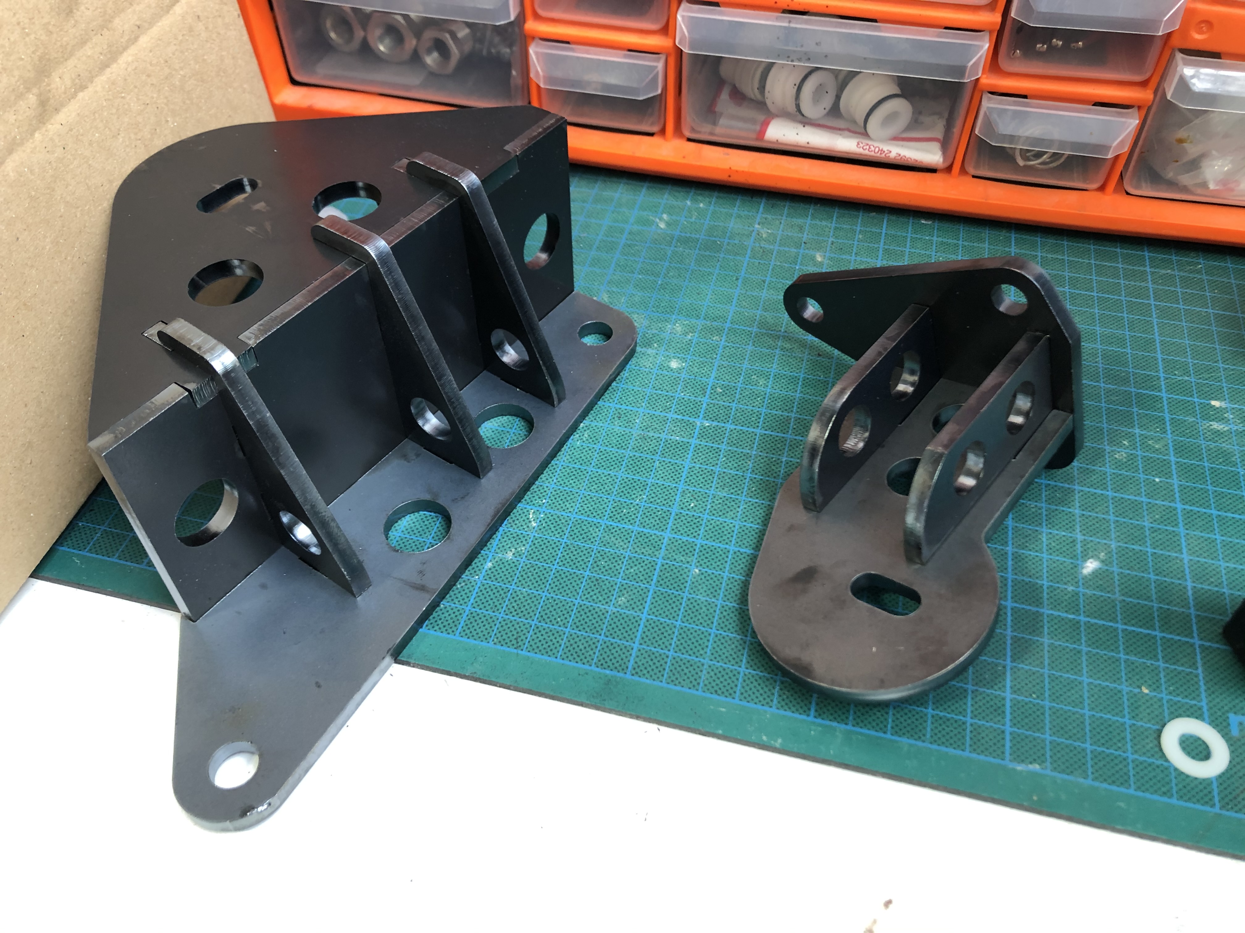

chrisdb Posted April 5, 2021 Share Posted April 5, 2021 Well done, that looks like a great job! I am considering doing the same next winter, which mounts/driveshafts/shifter etc did you use? Link to comment Share on other sites More sharing options...
jody391 Posted April 6, 2021 Author Share Posted April 6, 2021 8 hours ago, chrisdb said: Well done, that looks like a great job! I am considering doing the same next winter, which mounts/driveshafts/shifter etc did you use? Martin edwards drive shafts, Harry’s gear shifter and I made my own engine mounts. I tried to make it look as OEM as possible. Link to comment Share on other sites More sharing options...
