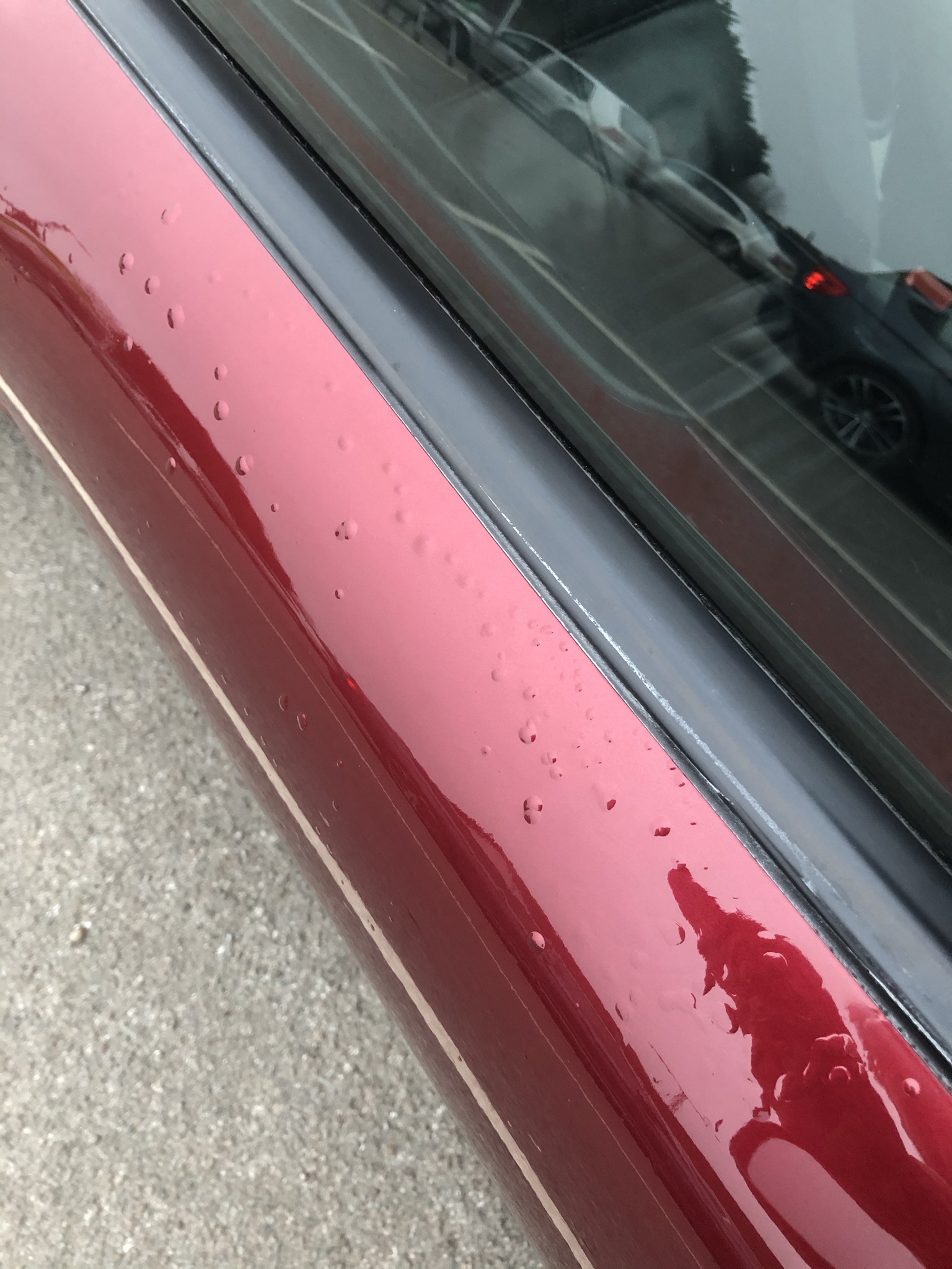

Betts Posted March 12, 2021 Share Posted March 12, 2021 Thanks, everyone loves the colour, not seen any others this burgundy red. What is doesn’t show is the very bad paint blisters on both doors - another job for later in the year. Link to comment Share on other sites More sharing options...
