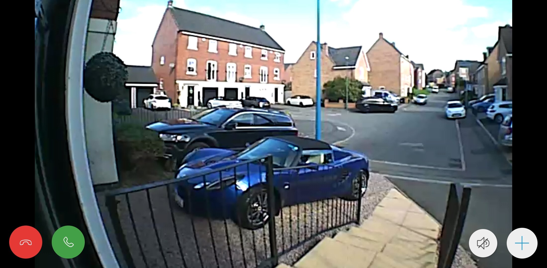

Neilshannon27 Posted August 24, 2019 Author Share Posted August 24, 2019 25 minutes ago, R5K said: I have issues if I park nose up, the drains are at the front of the boot back of the engine bay, if the nose is up hill the water just sits in the lip when you open the boot it goes in. Issue I have is that I have to park nose up. Its on a stone drive and is deep at the top so if I park ass up the back wheels just digs in and buries itself 😔 Need to find a fix for this somehow Link to comment Share on other sites More sharing options...
Neilshannon27 Posted August 24, 2019 Author Share Posted August 24, 2019 Sorry for the poor picture, taken from my ring doorbell Link to comment Share on other sites More sharing options...
The Cakes Posted August 24, 2019 Share Posted August 24, 2019 29 minutes ago, Neilshannon27 said: Sorry for the poor picture, taken from my ring doorbell Just reverse it on 👍🏻 Jobs a 🥕 Link to comment Share on other sites More sharing options...
Neilshannon27 Posted August 24, 2019 Author Share Posted August 24, 2019 1 hour ago, The Cakes said: Just reverse it on 👍🏻 Jobs a 🥕 I can't mate, the back wheels just spin and spit stones everywhere Link to comment Share on other sites More sharing options...

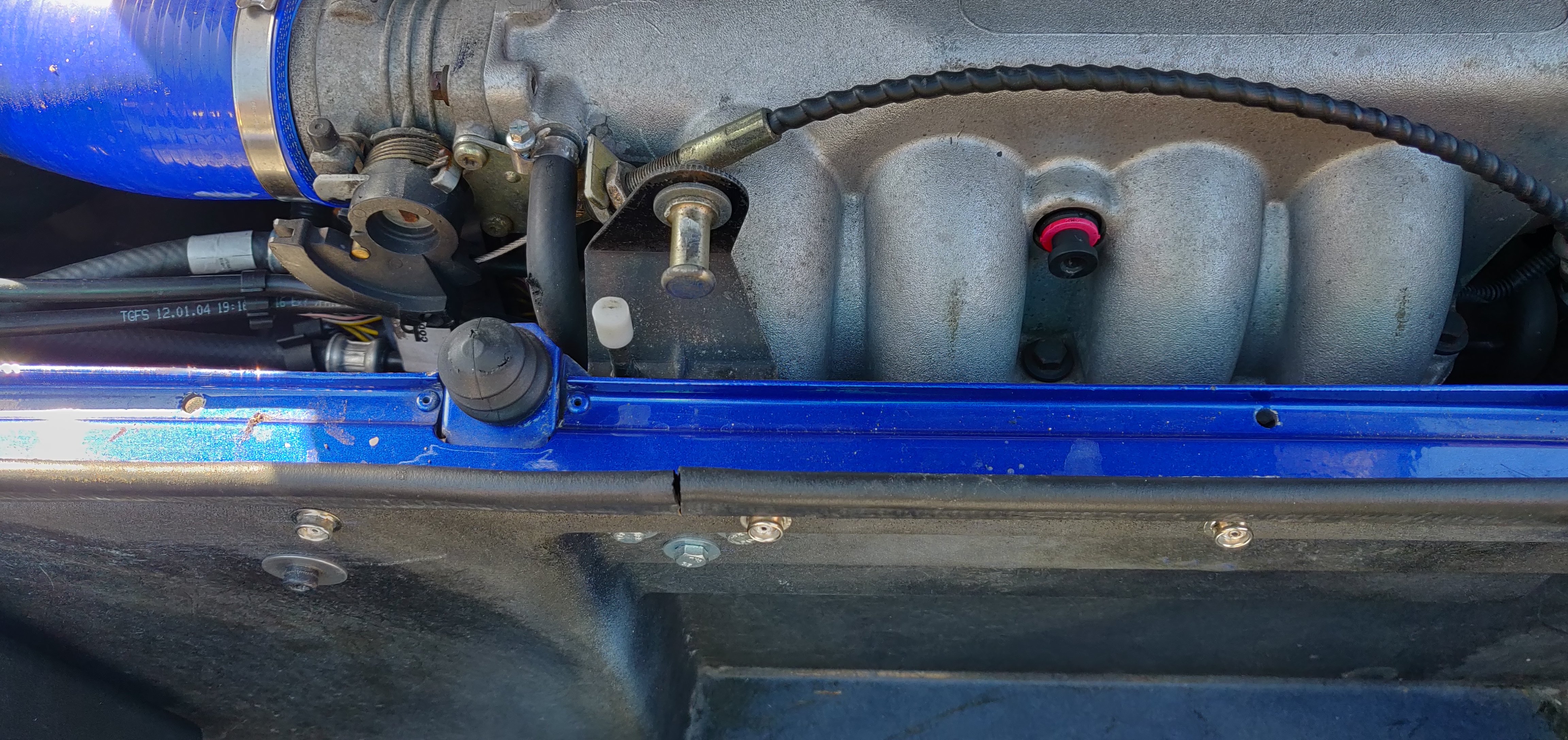

Neilshannon27 Posted August 24, 2019 Author Share Posted August 24, 2019 I have had a look this morning and guessing the holes are for the drainage but rubber seal has a massive slit in it which can't be helping, think I will need to put some sealant on it and around the plastic screws too Link to comment Share on other sites More sharing options...
The Cakes Posted August 24, 2019 Share Posted August 24, 2019 Probably not helping but as above have said it will be nose up, rear down the main culprit. Link to comment Share on other sites More sharing options...
Jonathan E Posted August 24, 2019 Share Posted August 24, 2019 As said above nose up is the issue, the drain holes for the boot are way back in the engine bay, water slowly fills from the rear of the boot channel and overflows into the boot. S1’s have a pipe fixed to the channel over the boot, the pipe runs down through the boot floor and the water drains away, unless you knock the pipe off while loading luggage and then the water just drains straight into the boot🙄. Lotus reintroduced the pipe system on early 111r’s but had problems with the paint bubbling on the rear clam where the drain pipe was fixed and so did away with it. A lightweight cover will solve the problem, or tarmac the parking space and reverse in👍 Its another little idiosyncrasy of Lotus ownership, it’s why we all love them so much🤔🤣 Link to comment Share on other sites More sharing options...

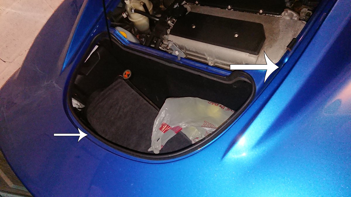

R5K Posted August 24, 2019 Share Posted August 24, 2019 If its not a steep slope, hard to tell of the Pic, if you went on a bit further and then reverse back onto some caravan type leveling ramps to raise the rear end up to level? Something like this: on mine ths issue isn't the holes in your picture its the ones at the front corner (large arrow) and the water pools at the back (small arrow). Mine only leaks if i open the boot that I've noticed after cleaning but it lives in a garage. My drive slopes upto the garage. Link to comment Share on other sites More sharing options...
crinkle Posted August 27, 2019 Share Posted August 27, 2019 On 24/08/2019 at 12:22, Neilshannon27 said: I have had a look this morning and guessing the holes are for the drainage but rubber seal has a massive slit in it which can't be helping, think I will need to put some sealant on it and around the plastic screws too Don't think it's a split , more likely where the two ends of the seal meet . Link to comment Share on other sites More sharing options...

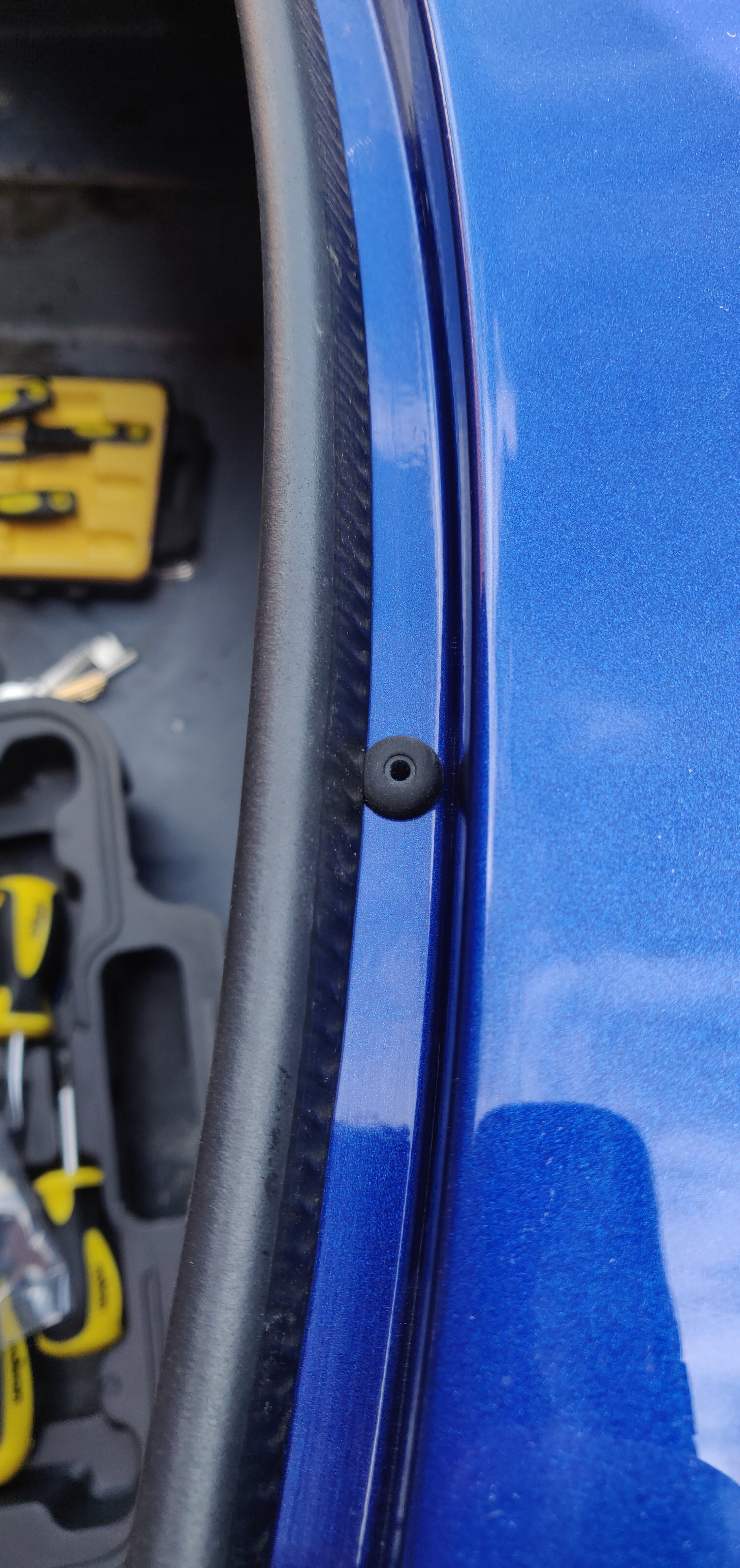

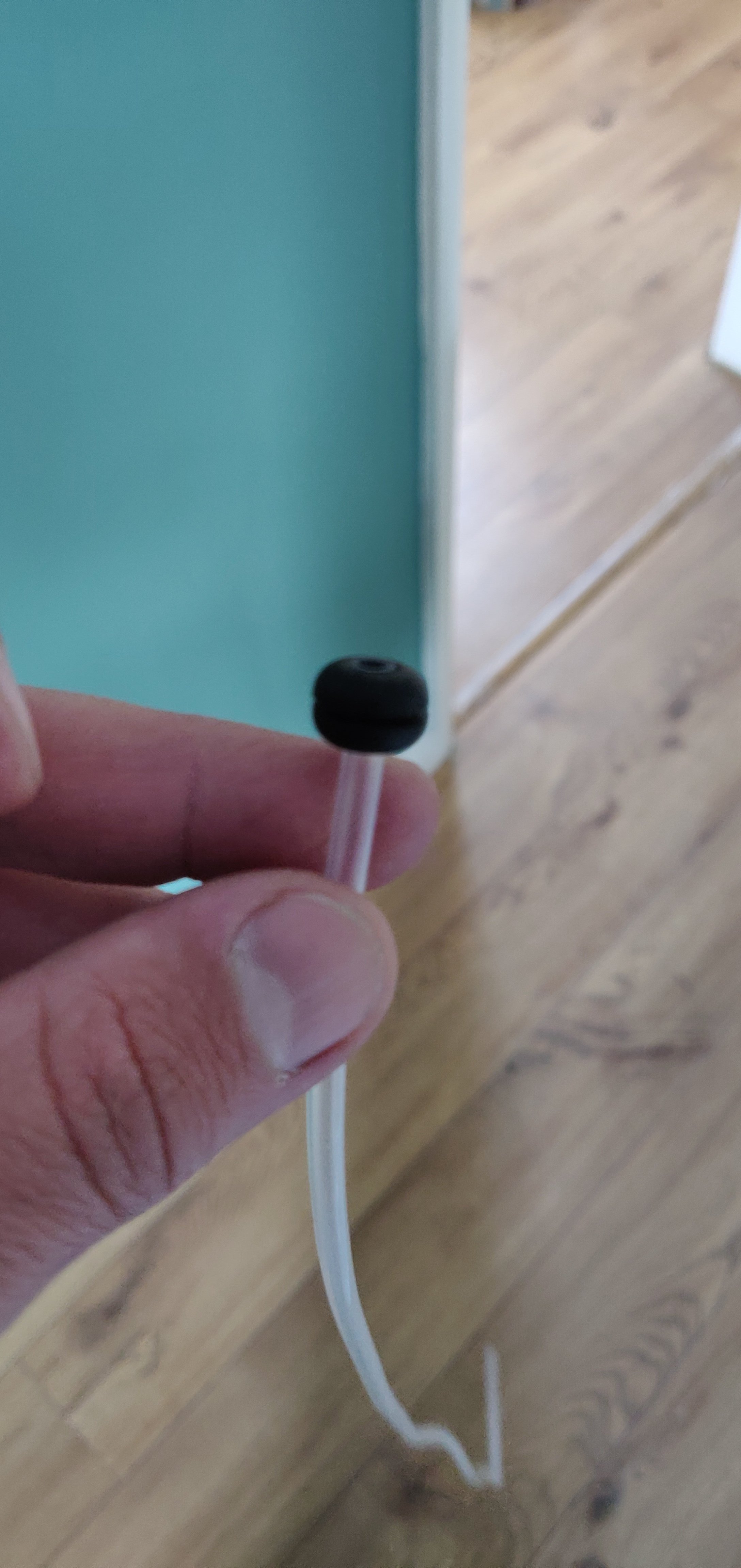

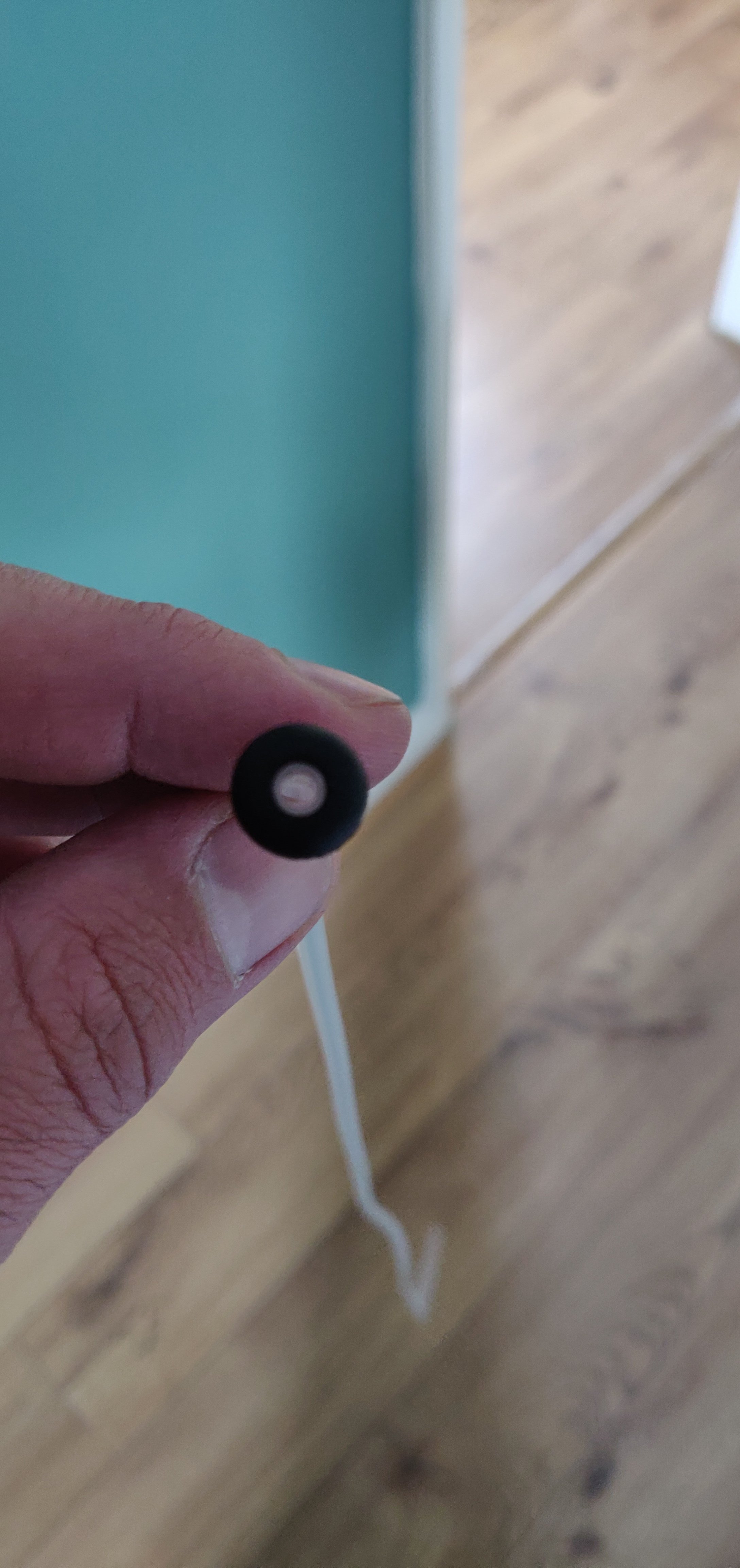

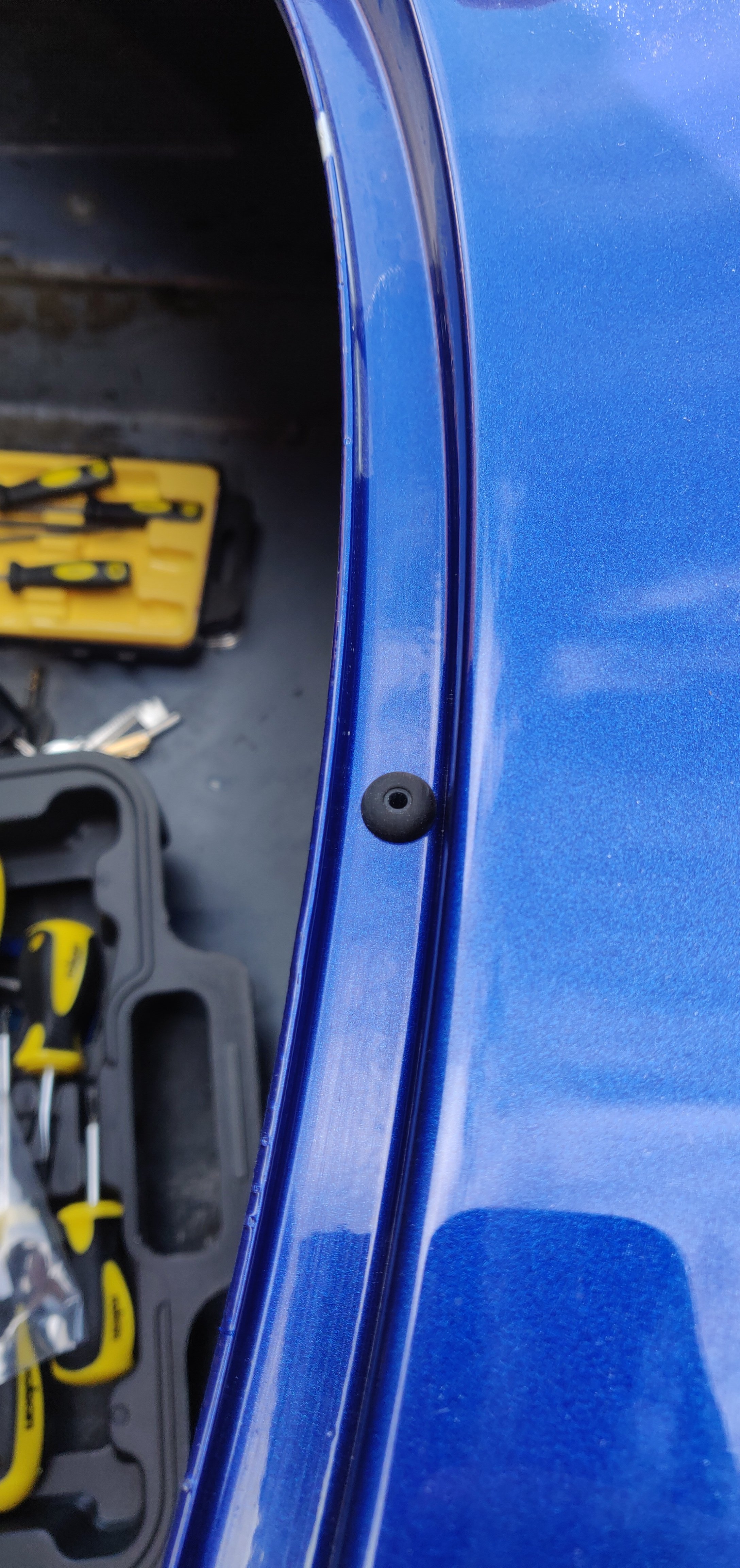

Neilshannon27 Posted August 30, 2019 Author Share Posted August 30, 2019 OK so rather than pay loads of money to tarmac the drive as I am looking to move within the next year I thought I would try and create a drainage system. Bought some 8mm rubber grommets with a 4mm inner circle for some 4mm tubing. And then drilled 2 holes right at the back and ran the tubes down to pop out in that gap just above the number plate (pictures only show one hole at the top but I put 2 in quite close to each other) will have to wait for some rain now and see if it works. Link to comment Share on other sites More sharing options...
