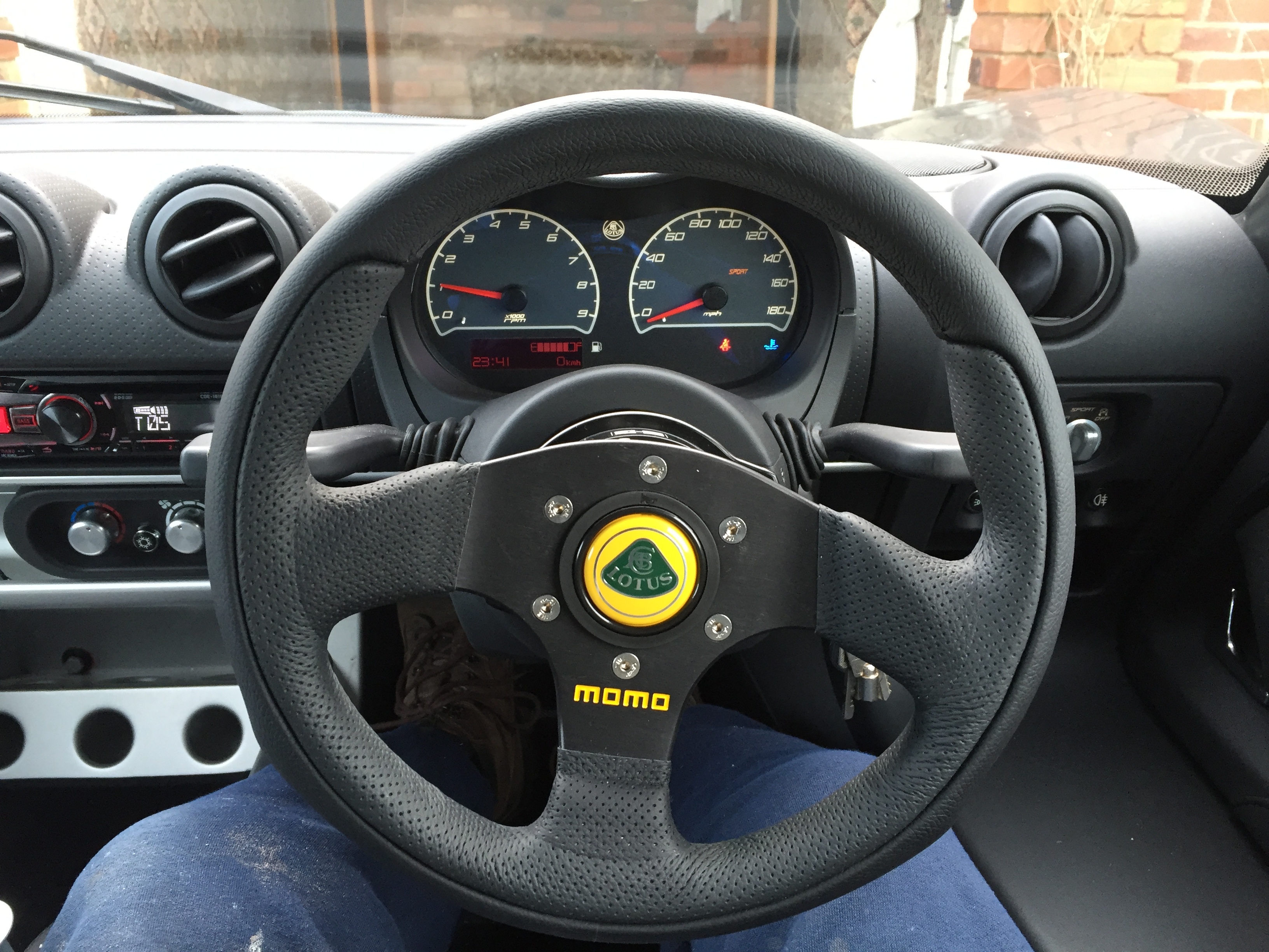

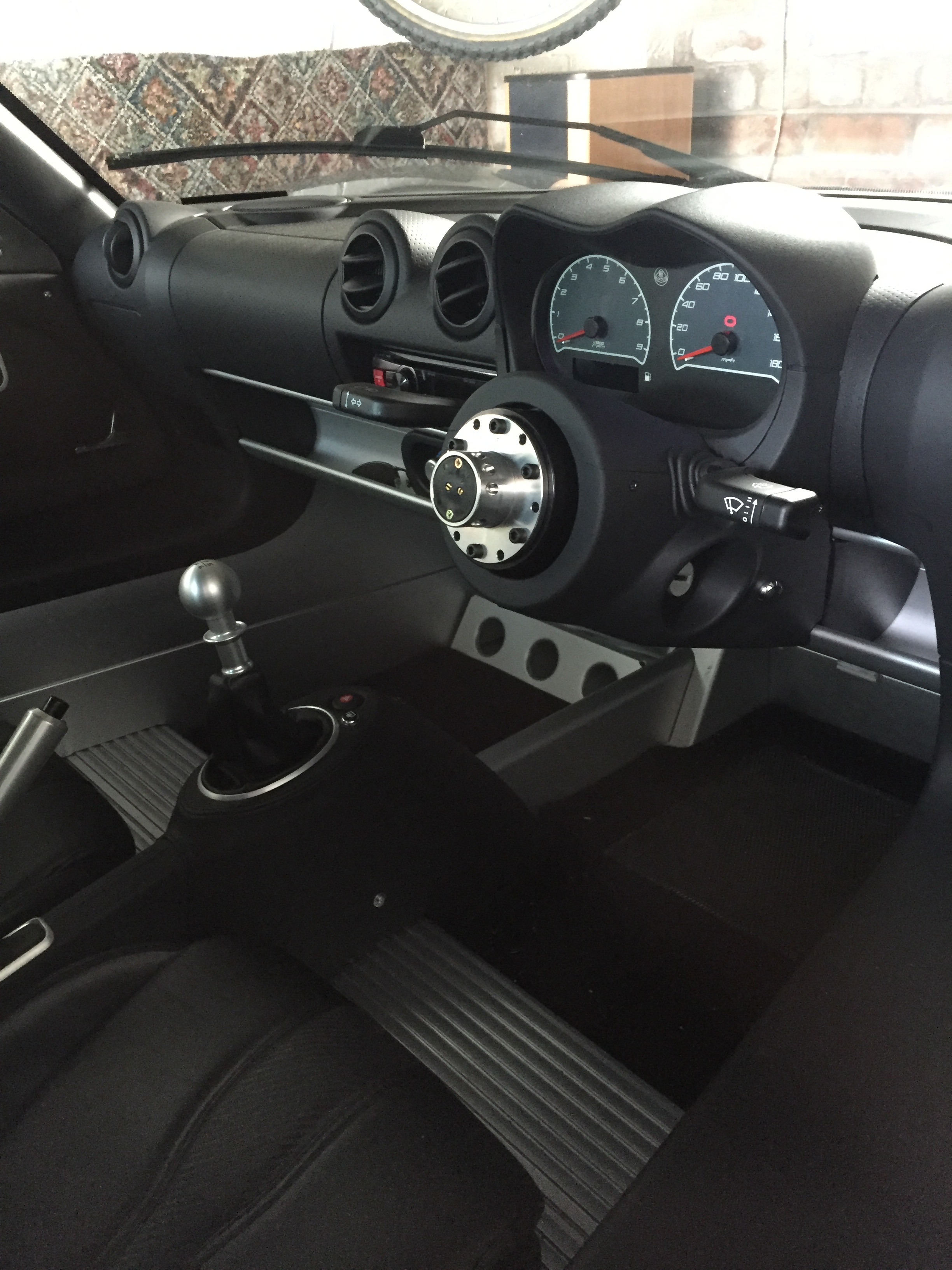

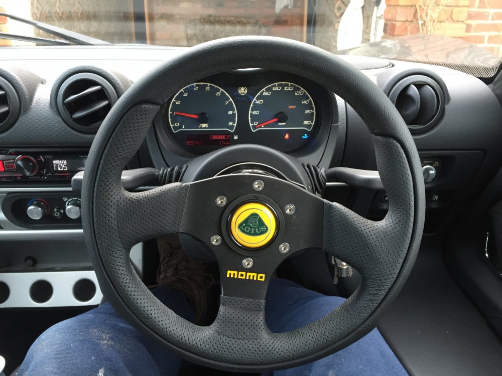

stratosboy Posted March 11, 2018 Share Posted March 11, 2018 I got myself the smaller 280mm Momo Team wheel too on a Brown & Geeson removable hub (these are fitted by Lotus to the Cup cars) Link to comment Share on other sites More sharing options...
Christopher Lawless Posted March 11, 2018 Author Share Posted March 11, 2018 16 minutes ago, stratosboy said: I got myself the smaller 280mm Momo Team wheel too on a Brown & Geeson removable hub (these are fitted by Lotus to the Cup cars) That looks a real nice bit of kit. If you don't mind me asking, how much was the removable boss and where from? Does it run on splines? Link to comment Share on other sites More sharing options...
stratosboy Posted March 11, 2018 Share Posted March 11, 2018 got mine from Dave at Seriously Lotus quick release coupling below is £98 + VAT and the hub which fits onto the splines is £160 + VAT please note that by fitting this into an airbag car, you loose this. Link to comment Share on other sites More sharing options...
Christopher Lawless Posted March 11, 2018 Author Share Posted March 11, 2018 What's the play like in it? As Dean says I want to go for the tightest feeling one out there really. Link to comment Share on other sites More sharing options...
stratosboy Posted March 11, 2018 Share Posted March 11, 2018 really good quality - no play whatsoever, heard the Snap-off type hub is more prone to wear do a search on Seloc, there will be reviews of these on there. I did quite a lot of research before deciding on this removable hub for exactly the same reasons you are. Link to comment Share on other sites More sharing options...

scatty Posted March 13, 2018 Share Posted March 13, 2018 I had the 300mm momo on my previous, same as the others just slightly bigger. But much smaller than standard. I got the Elise parts removable boss as well. I didn’t find it particularly easy to fit and line up. The b and g one looks loads better. Worth trying both wheels as the 280 felt too small for me and slightly obscured the dials, but I am giraffe like. Deffo the best looking wheel though imo. Link to comment Share on other sites More sharing options...
Christopher Lawless Posted March 13, 2018 Author Share Posted March 13, 2018 Yeah I don' find the standard wheel "too big" so may be slightly smaller would be ok but wouldn't want to go loads smaller. I thought the Elise parts one had dots to line up everything? I do like the look of that B&G one. How easy is it to take on and off and line up? Link to comment Share on other sites More sharing options...
stratosboy Posted March 14, 2018 Share Posted March 14, 2018 13 hours ago, Christopher Lawless said: I do like the look of that B&G one. How easy is it to take on and off and line up? just pushes on, will only fit in one position, so hub has to be fitted exactly right. Mine is dead centre. To remove: depress small button on top of B&G unit, pull paddles towards wheel and wheel disengages from ball bearings (you'll see from my earlier pics the indentations for these on the top hat section of the removable kit. There isn't any other moving parts to wear as such. I had mine fitted by Ind Lotus specialist due to airbag needing deactivating, small fuse needs to be fitted and horn wiring needs a slight mod. Link to comment Share on other sites More sharing options...
