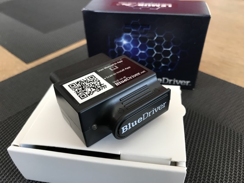

Ok i will do that and let you know the feedback. In the meantime I ordered an OBD2 Bluetooth dongle (this one here http://www.lemurmonitors.com/)
It should be delivered early next week. Anyway, now I am off to a Toyota to get the exact codes and maybe some advice from the techs there.

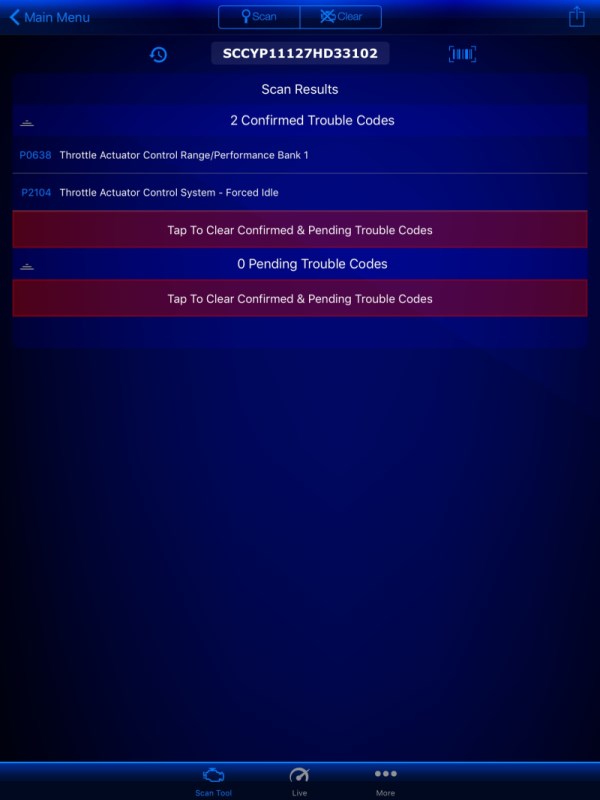

Ok, I just came back from that independant workshop where I had the car connected to an ODB reader (it cost me 25€...). Here is the codes I got on the car:
- P0638 : Throttle Actuator Control Range/Performance B1
       detazils here => https://www.obd-codes.com/p0638
- P2104 : Throttle Actuator Control System - Throttle actuator control system is in FMEM mode of forced idle
      Possible causes - List of elements that might trigger the appearance of this code
           PCM damaged
           Multiple ETC system faults
           Bad APP sensor
      Diagnostic help - Some tricks to help us for the diagnosis of the failure
           DTC indicates FMEM condition, and can be set in combination with DTCS P2121, P2126, or P2131 and P2111 or P2112. When P2104 is set in combination with P2121,
           P2126, or P2131 repair Accelerator Pedal Position Sensor faults first (pinpoint test DK), when the P2104 is set in combination with P2111 or P2112 repair the Electronic
           Throttle Body faults first (pinpoint test DV).

If I've read those codes correctly then:
P2014 - This is just status from the ECU telling you that's it's gone into the limp mode due to some other fault.
P0638 - I think this is the root problem.
I'm guessing the toyota model has a fly by wire accelerator in which case there is a stepper motor driving the throttle opening rather than a cable. The 638 error is complaining that the ECU has set the throttle position but the TPS is reporting back a different position. So either the throttle isn't being set correctly by the stepper motor or the TPS is reporting the wrong value. Think I'd test that TPS to narrow it down a little and then (assuming it's OK which it probably is) I'd check the price of a new throttle body before taking the old one off and having a bit of a clean and spruce up anything obviously gummed up.

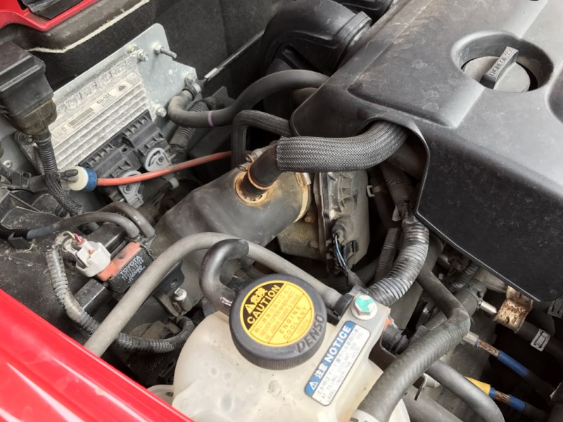

Hello guys, I have some news for you.
As already mentionned, I bought an ODB Reader and I must say it's working quite well. I'll attach some screen shots.

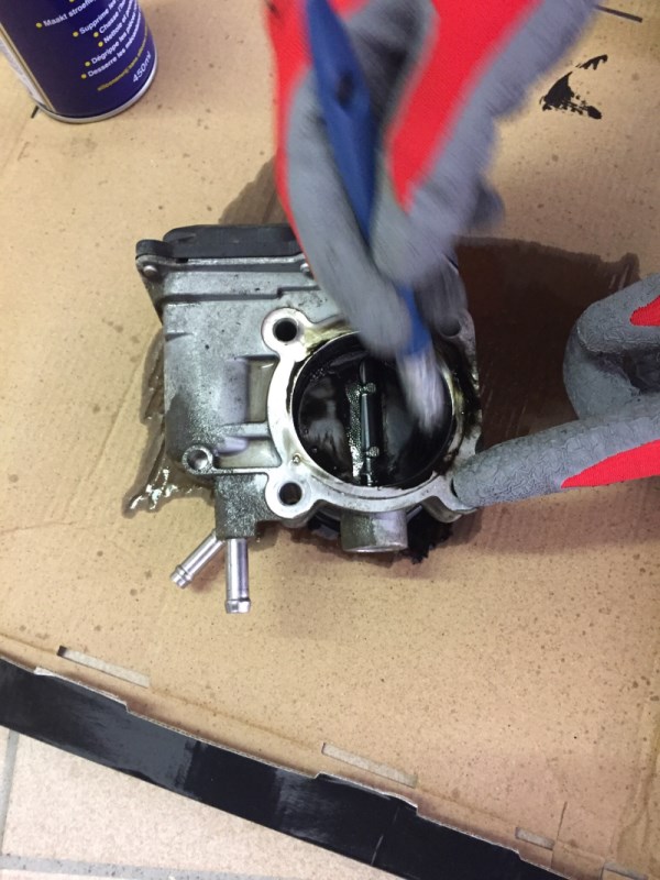

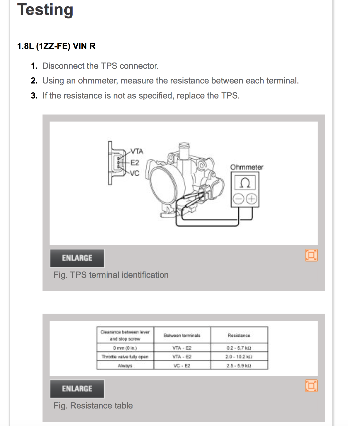

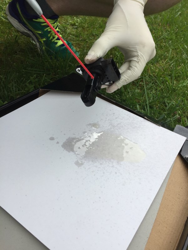

Besides this, with the help of a friend, I removed the throttle body and cleaned it with wd40 (couldn't find carburetor cleaner). There was some black dirt in it but not much. It was pretty clean. We also tried to test the actuator/sensor with a multimeter but this wasn't succesful. The only explanations I found (one of the earlier post from Digimap2k) on the ohms open & closed is for a different type of Elise throttle body so it could not be applied. We also cleaned the mass air sensor in the air box (also with wd40, not sure that's a good idea).
After putting everything carefully back together in the engine bay, and adding some coolant fluid lost in the operation (throttle body is watercooled whatthahell.gif) we started the car succesfully. The MIL was gone! We then decided to go for a quick ride, get the car to temp, make sure all is ok the stop the car and start it again while hot. No problem , everything fine.
A bit later, my friend who actually is the co-owner of the car, needed to go fetch someone at the tube station and he decided to use Elise (who could resist?). When he trie to start it, MIL was on and the erratic idle was there again. facepalm.gif Disapointed, I decided to open the engine bay and disconnect the throttle body connector, wait for a few seconds on connect it back. This manipulation made the idle normal again !
Conclusion, I definitively have an issue with the electronic part of the throttle body. Do you agree with that statement ?
This doen't seem to be repairable: the electronic box is riveted so I suppose that opening the thing would cause damage to the internals and prevent any future usage...
I will try to source a second-hand throttle body from a 1ZZ. THere are some available on ebay (from uk) at around 60€ but i'll try first to find it in Belgium (easier for warranty).
Does that sound like a good idea to you ?
Cheers
