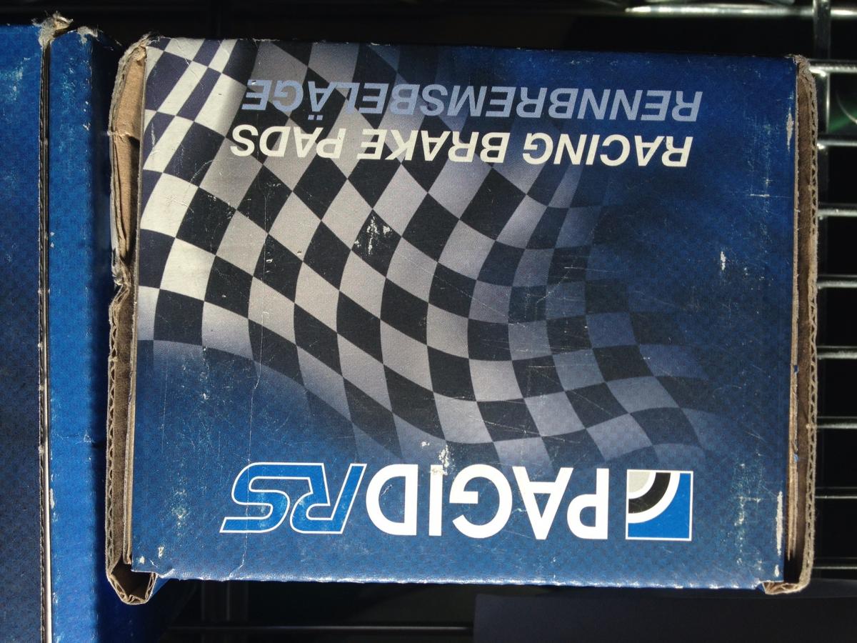

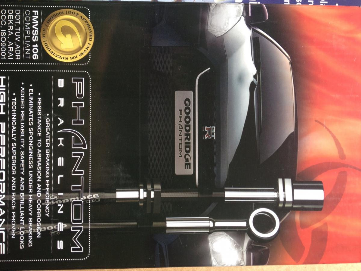

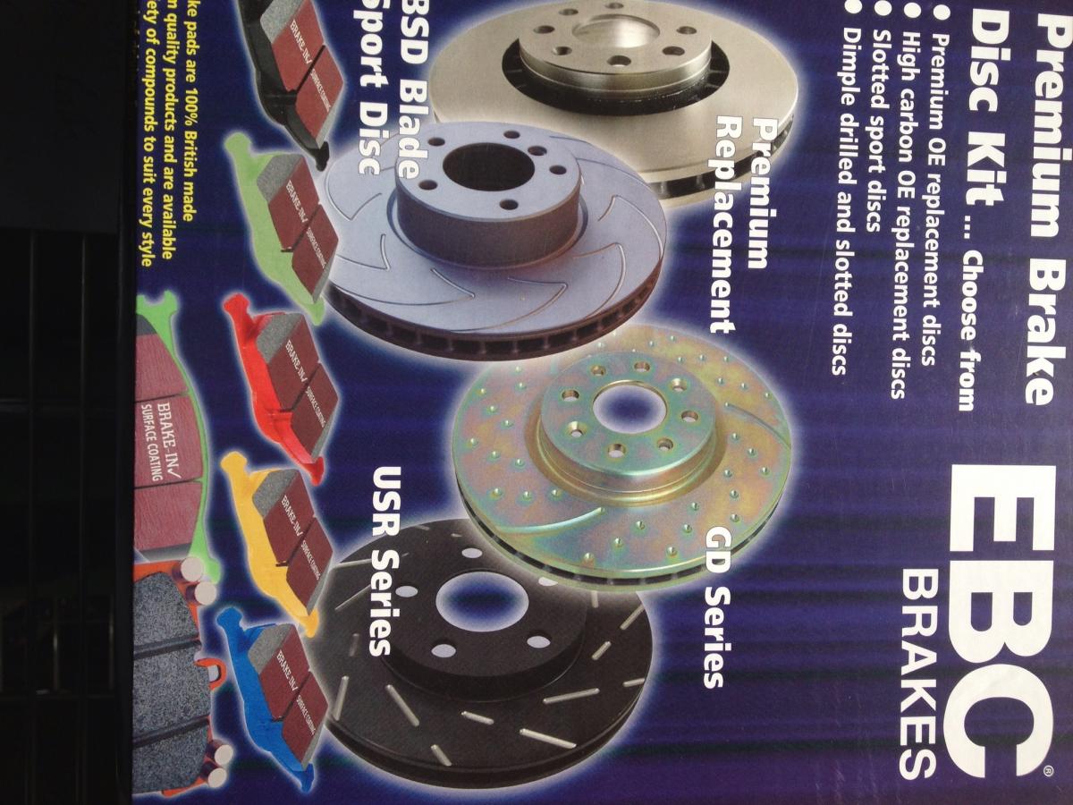

smithpaulg Posted May 31, 2013 Author Posted May 31, 2013 Well thanks to everyone for their advice ! As you can tell there was quite a spread of options so I have gone for the EBC turbo grooves all round with the pagid 4-2s. Hopefully I wont live to regret it (edit my decision)! Also, by changing my disc choice I managed to fit braided stainless hoses and fluid into the deal as well (cheers Dean and Russell). Gary thanks for the advice, as I also ordered some replacement cheese retaining screws. So just to warn you next weekend you might here a shout for 'Help!' (Scatty need not apply!) I will let you know how I get on, or i will be giving Gav a call. Cheers Paul ps I am regarding this as an enhancement (not an upgrade) so it doesn't count towards the trophy!

smithpaulg Posted June 16, 2013 Author Posted June 16, 2013 Well next weekend it has been decided... I will be fitting (and probably cursing alot) the following.....fronts and backs. Not sussed how to rotate the images yet though. Hopefully more luck with the actual items. Gav might need to help me with some of it!! Thanks Paul
