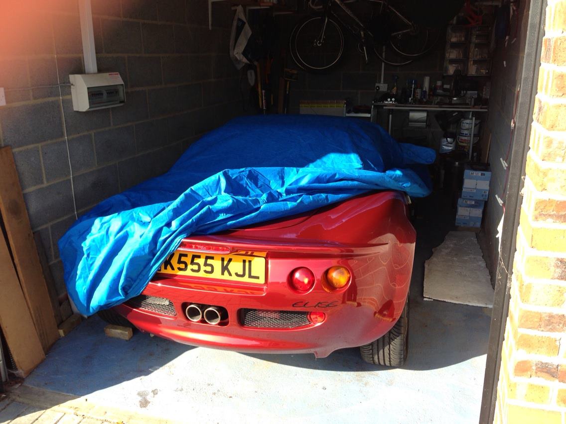

kayj_prod Posted April 21, 2013 Posted April 21, 2013 Nervous morning yesterday as Elsie has been under wraps since last October. I grabbed the chance to squeeze her MOT in while I had a spare morning. I was so pleased when the engine turned over without so much as a splutter! A quick whizz to the garage via the scenic route to warm her up and give the brakes a little work. Straight through the MOT with no problems and I'm a happy chap. Back home via the scenic route again and I spent the rest of my day finishing the last job of my rebuild from last year. I never did get the windows fixed properly last year (PITA job if ever there was one) as I rushed getting it done for the geo day at Toll Bar. Well, it was still a PITA job as my knuckles will attest, but I now have windows that go up and down without the need to pull at the top of the glass. After some very careful adjustment, they also seal properly with the roof on- so fingers crossed for when inevitably, I get caught in the rain. Busy weekend next week, so I'm holding off taxing her until the bank holiday weekend. Fingers and toes crossed for great weather at the start of May.
