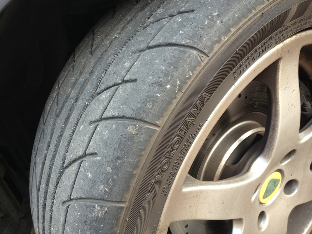

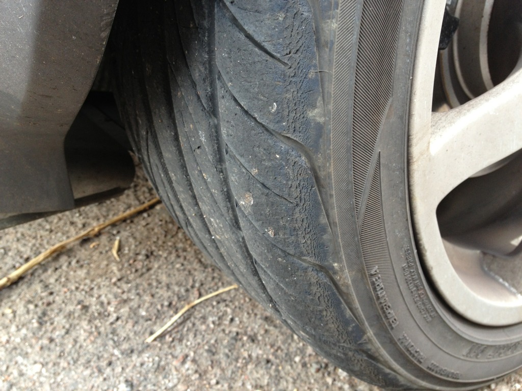

DanP Posted April 19, 2013 Posted April 19, 2013 Once again thank you RIB for taking the time to reply - I appreciate it! The only thing I suppose I can not get my head around, is the fact that Lotus and the tyre companies must have spent hours and hours on road and track developing the tyres and you would have thought that they would have spotted the fact that they wear in middle of the tyre and recommended lower pressures? Although I think you may have a point, potentially, with the fact they may want to induce understeer rather than oversteer as this potentially easier to control. Mark It's been said that the standard lotus tire pressures induce wear in the middle of the tyre (during road use?). How do people find the wear during track use? So far in my limited experience, the edges of the tyre are hammered much more, and the wear is much more on the edges of the tyre, and might be even worse if you used lower pressures?
stockhome Posted April 19, 2013 Posted April 19, 2013 Sounds weird if its wearing the edges if anything you would expect trackdays to make it wear even worse in the centre. Is it both edges of the tyre or just one. Probably worth getting the geo checked

DanP Posted April 19, 2013 Posted April 19, 2013 Sounds weird if its wearing the edges if anything you would expect trackdays to make it wear even worse in the centre. Is it both edges of the tyre or just one. Probably worth getting the geo checked I've just measured the tread depth, an it is pretty even all over, with the tread near the outside wall looking shredded. Front: Rear:
stockhome Posted April 19, 2013 Posted April 19, 2013 The standard Geo settings are here http://wiki.seloc.org/a/Geo_Setups it always worth getting them checked as elise's are very sensitive to how they're setup. And a few mm can make a massive difference to how they handle. HTH
