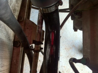

kayj_prod Posted April 28, 2012 Author Posted April 28, 2012 Back to working on the car today... rebuilding rear suspension, replacing the heat shield etc. (I'd make quicker progress if it wouldn't keep raining.)... Anyway, it reminded me: When I removed the original cooling system, there were a couple of little cable-tie-spacers between some lower pipework. They are obviously there to stand one pipe away from another. Although I removed the cable-ties without snipping them, they aren't long enough to re-use on the larger outer diameter PRRT silicone. Do you think I need to find a replacement way to stand the new pipes away from each other?

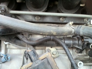

kayj_prod Posted April 28, 2012 Author Posted April 28, 2012 Of course. You can see in the photo where one of the stand-offs still on the metal pipe holds the plastic tube away. My concern is towards the top of the photo where the metal pipe is touching the new silicone pipe. It can't really be a heat thing can it, because both of the pipes are eventually going to be roughly the same temperature- well the coolant inside. Maybe abrasion or just rattles?
Phil S1 Posted April 28, 2012 Posted April 28, 2012 I have just fitted my Eliseparts PRT too Keith, it's not fully connected yet because the head's not on but I have exactly the same condition as you. For the moment I have put a bit of self adhesive foam padding on the metal pipe where it touches the new silicon one but I'd be interested to hear if anyone's got a better solution.
Elise+Imp Posted April 28, 2012 Posted April 28, 2012 I'd go for back to back P clips, one on each pipe, use a longer Bolt if needed and a spacer or stack of washers between them to replicate the gap created by the original plastic clips, which are incidentally to keep the pipes separated to stop chafing.
kayj_prod Posted April 29, 2012 Author Posted April 29, 2012 Thanks for that idea Brian. I can imagine stuck on foam- rather than a foam sleeve- coming off eventually, Phil. (Seems to me you've got way more significant things to think about at the moment with your KR1 thread!) Car work is called off again due to rain today. Parking the car in the garage front first seemed like such a good idea back in February!
