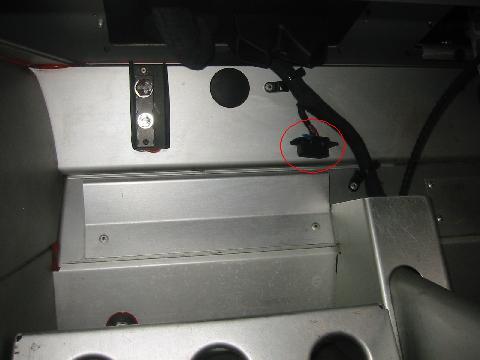

<p> </p>
<p><img src="http://www.midlandslotus.co.uk/wiki/images/d/d3/Passenger-footwell.jpg" alt="Passenger-footwell.jpg"></p>
<p> </p>
<p>It's actually a diagnostic connector, so don't worry, it's not a connection that has come loose!   </p>
<p> </p>
<p>A device, such as an <a href="http://www.obdkey.com/" rel="external nofollow">ODBKey</a>, can be attached and used to monitor vehicle information from the ECU.</p>
