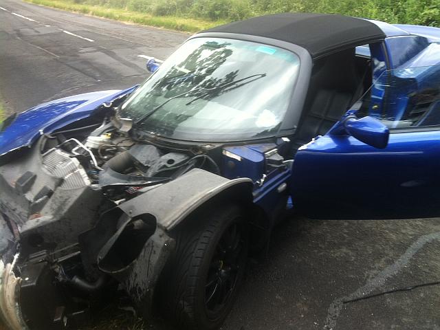

Hammered Posted July 1, 2012 Posted July 1, 2012 Had a little accident can anyone recomend any good one's Thanks Rich
fentuz Posted July 1, 2012 Posted July 1, 2012 It seems the car has lots of damage. As mention in the other thread, it would need clam, crash box, radiator. But just on this picture, it seems the brake master cylinder got torn off. The front passenger wheel has moved quite a bit; are the wishbone deformed only or have they torn chassis mount off? If the chassis is damaged, it should be written off especially since it's not weldable. You might want to contact Steve
AL. Posted July 1, 2012 Posted July 1, 2012 As above, take some photos of the wishbone mounts, especially the top mounts, and any sections of chassis that you can see at the front.
Martin R Posted July 1, 2012 Posted July 1, 2012 I would be suprised if its not written off. They work on a percentage of the total value. If its more than this to repair it will be written off. You may get the chance to buy the scrap back if they do. Price dependant this may be worthwhile as a project. As above any suspension mounting damage, forget it.

jimbo07g41 Posted July 3, 2012 Posted July 3, 2012 Most customers would push their insurance company for a new clam. The insurance company concerned about the cost of clam and paint will write off. If you have most of the pieces you will be surprised on what a good job a body shop can do. The main worry will be suspension damage, if thats ok and it was a good car, go for it. I wouldnt use the dealer If I was using my own money.

dobbo Posted July 3, 2012 Posted July 3, 2012 Personal experience, albeit from ~10 years ago, would be to avoid JCB100 like the plague. I'm not going into detail on a public forum and things could well have changed since then, but it took me to start a court action against them to get my problem sorted. EDIT - just looked at the photo - can't see it not being a write-off, I'm afraid. At least that would save you having to discuss your choice of repairer...
Hammered Posted July 3, 2012 Author Posted July 3, 2012 Personal experience, albeit from ~10 years ago, would be to avoid JCB100 like the plague. I'm not going into detail on a public forum and things could well have changed since then, but it took me to start a court action against them to get my problem sorted. EDIT - just looked at the photo - can't see it not being a write-off, I'm afraid. At least that would save you having to discuss your choice of repairer... I know thats a possability, just trying to get it assessed by a company that has a good rep!!!! Yes give frank a call there short the car out with a DVD on the work they carry out on the lotus . They do a little discount being a club member . Spoke to him at the classic car show on the Lotus Drivers Club Stand last year . Eddie I'll contact these guy's tomorrow.....would be nice to find somewhere a bit more local just incase of any issues. I'm trying to get it assessed at home. And get a desicion of the insurance company before anyone takes it away. quite fancy the project if they right it off and theres no chassis damage. Hands off my car unless you gunna fix it propper....lol
