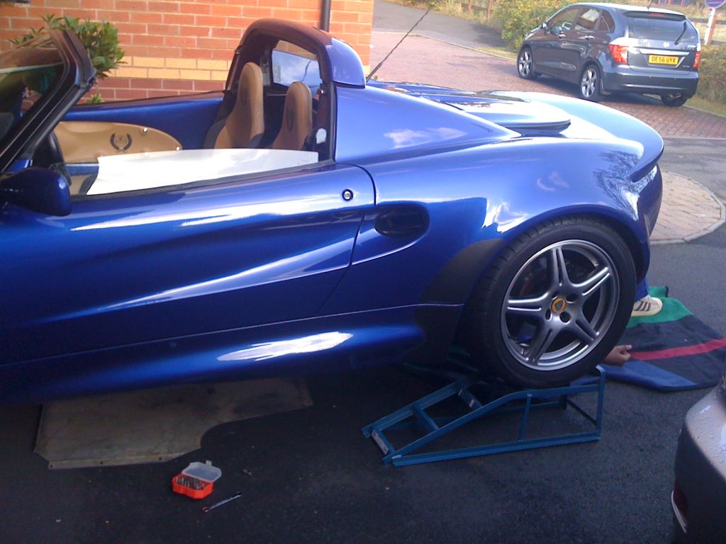

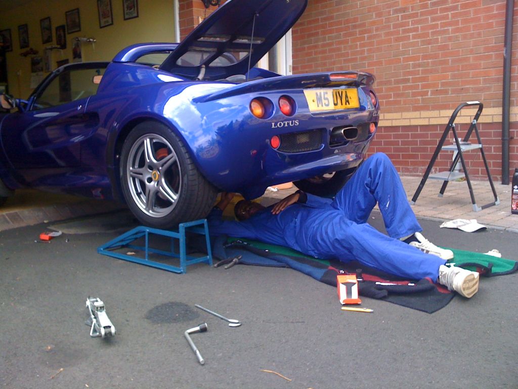

So, the first job is to get the car backed up onto the ramps. I must admit, I have done this several times, but I just can't get used to it.
Well, after lining up the ramps, I had my 'little' Bro backing me up and place the car on the ramps.

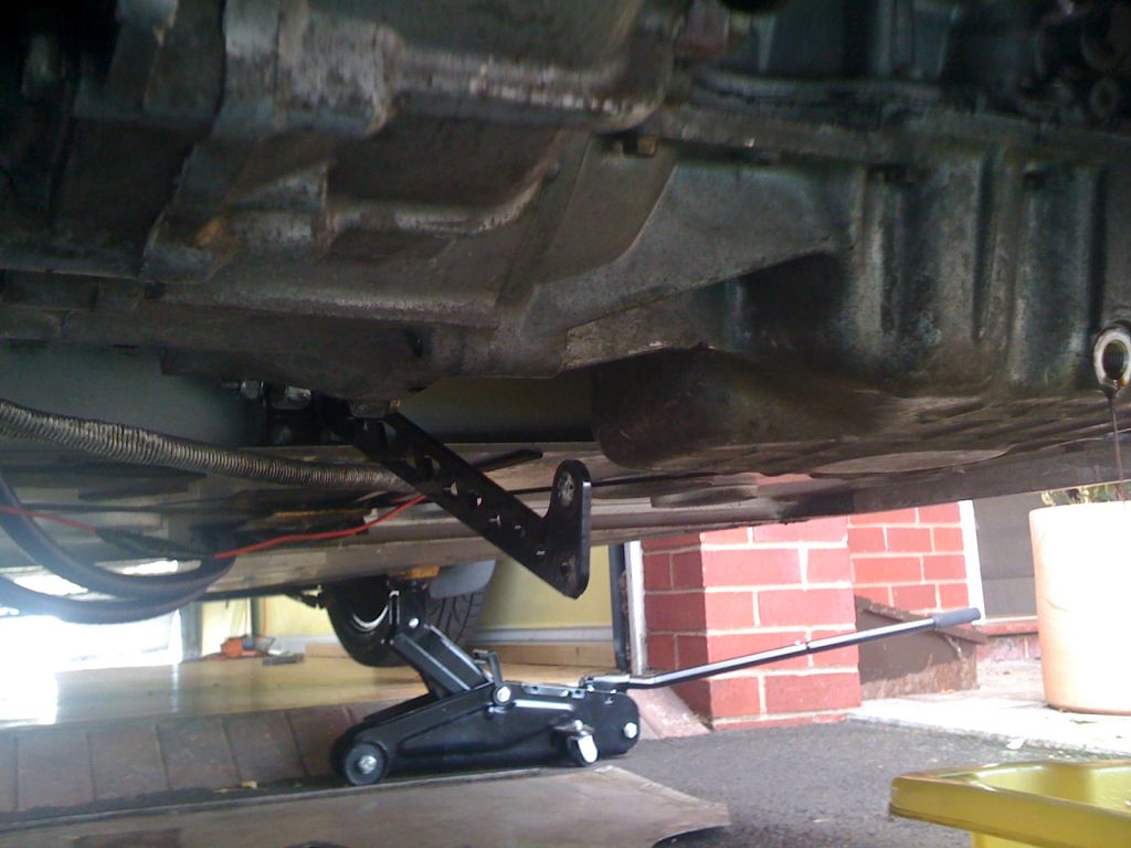

Then it was a matter of removing the rear diffuser and the centre undertray section. This gave me ample access to the whole of the engine from under the car.
Prep work

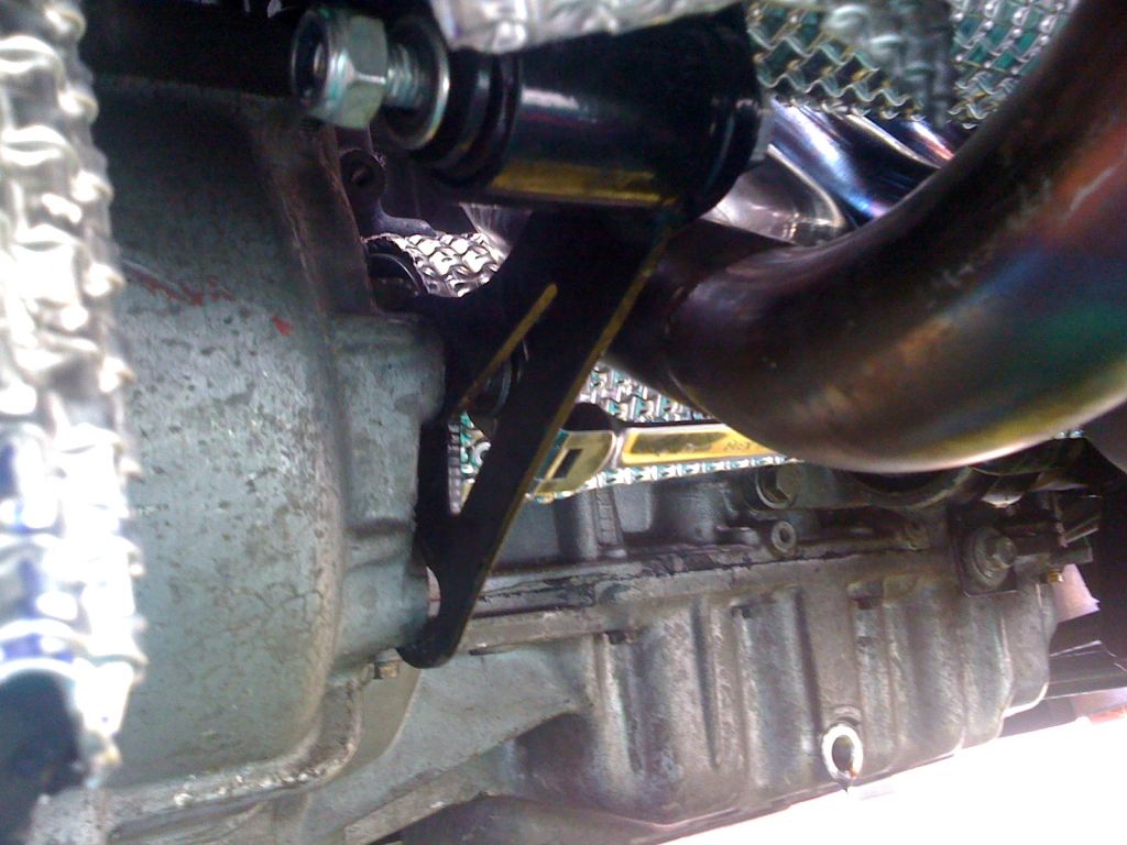

To gain better access to the oil filter, I removed the bolts for the two underside steady arms to allow me to rock the engine to give a little bit more access room.
Once the bolts were out, I was able to move the engine by about half an inch. It doesn't sound a lot, but this game me enough room to stick my hands through either side of the far side drive shaft subframe holes and just about get hold of the oil filter.
After a bit of strength work, I was able to twist the oil filter loose by hand.

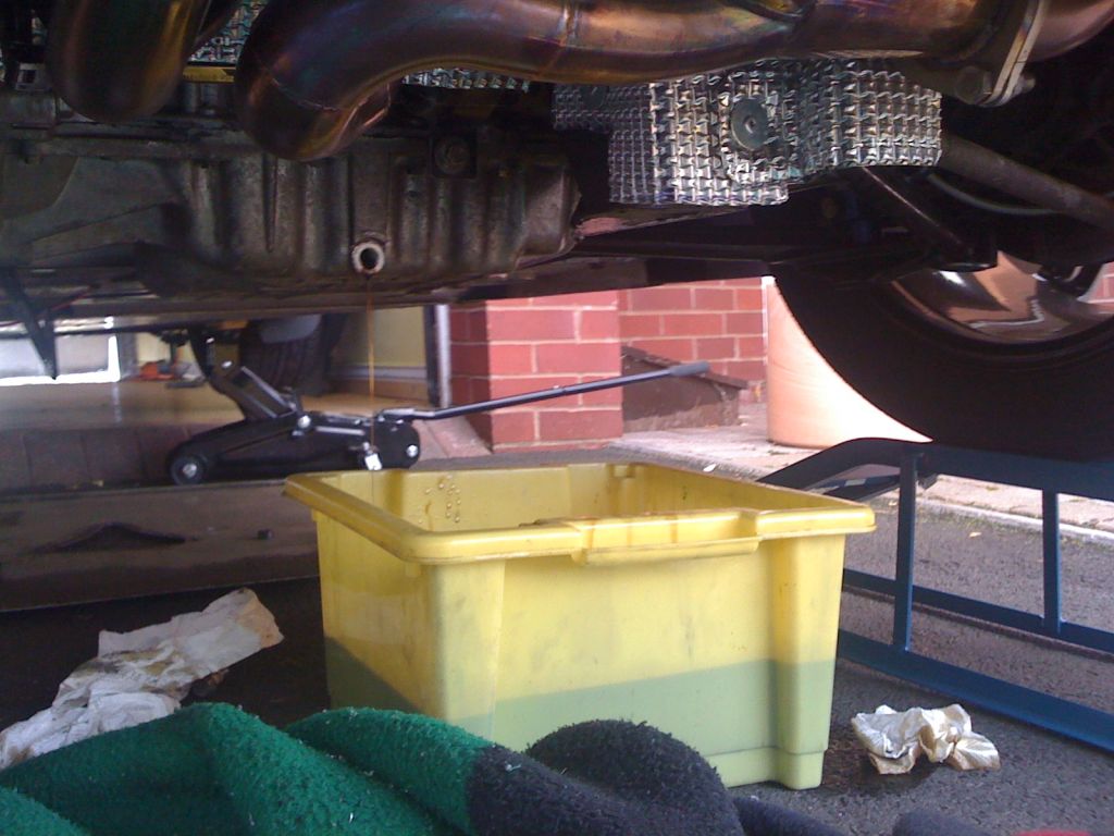

TIP:- Drain the oil first before undoing the oil filter. This will prevent you receiving a face full of aged Pro S :(. Note that the only reason for me taking this approach this time round was that I was unsure as to whether or not I was going to be able to remove the oil filter. I needed the option of aborting the whole thing if I failed.
After the oil filter was out of the way, I then removed the filler cap and the drain plug. Be careful where you place the collection pan. I was surprised just how far out the oil shot out and it almost missed the pan.

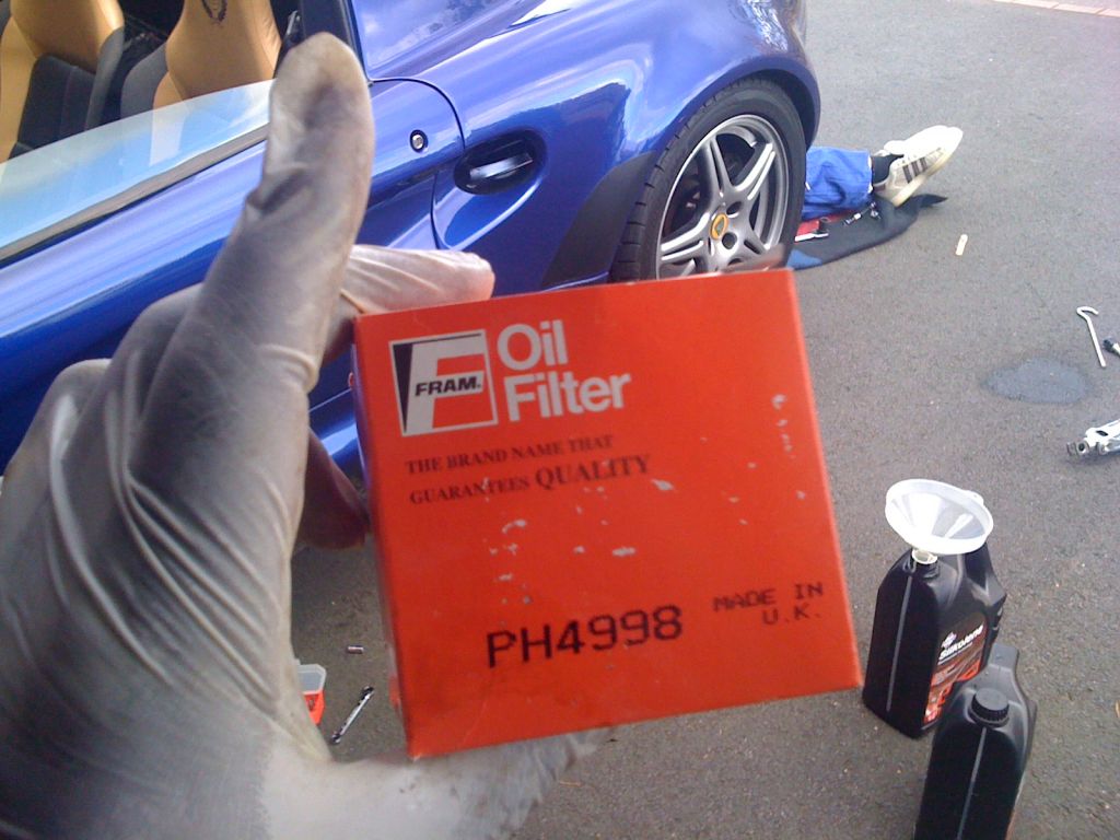

After a bit of research, it turned out that there a number of viable options when it comes to oil filters. I wanted something that was shorter than what I had previously, so I went for this...
Once the engine was completely drained, it was a very simple exercise to hand tight the new oil filter in place (don't forget to oil the rubber seal on the filter) and put everything back in place.
