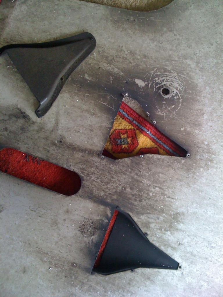

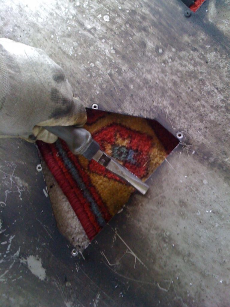

First job was to remove the off side naca duct by drilling out the rivets...

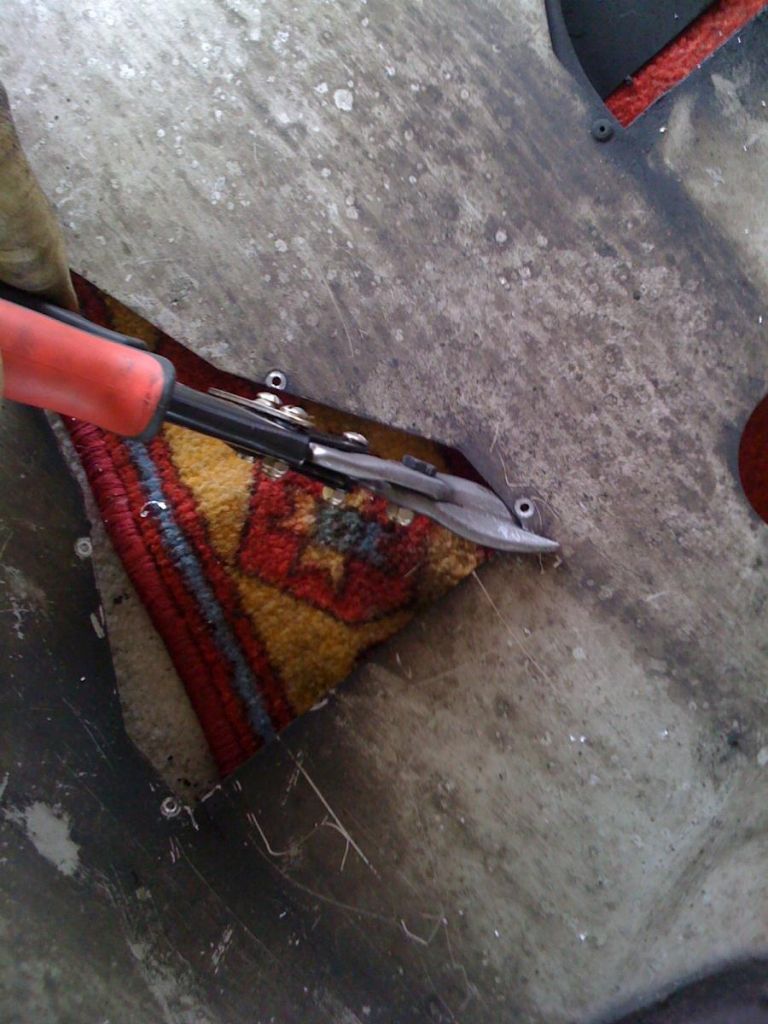

Then to aid cooling, cut two slits either side of the opening...
Then bend outwards to act as a scoop and ram more air in the space between the undertray and the engine.

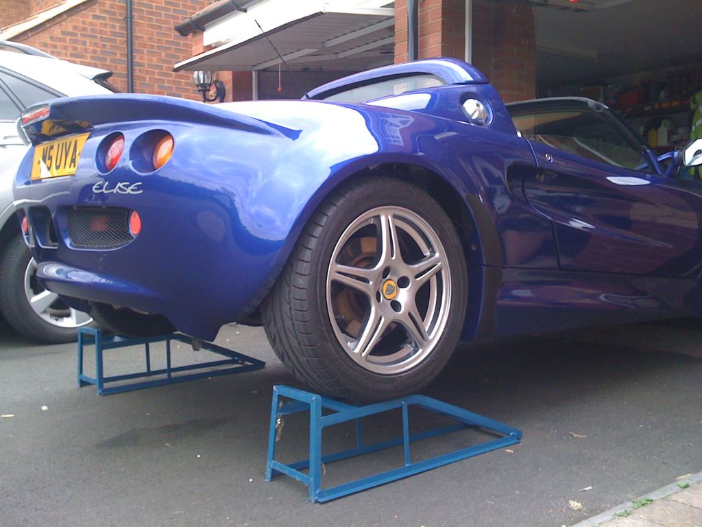

Once that was done, I decided to reverse the car up the ramps (I couldn't be bothered to jack the car up) and started working on the installation.
TIP: I used this opportunity to double check and spanner fixings, check for leaks or anything unexpected

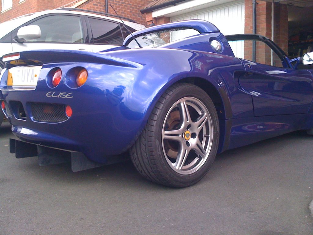

After an hour or so, she started looking like her old self again...
Still unwashed and full of operation scars, but with a little TLC, she will hopefully be looking better than ever...
