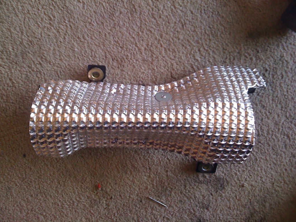

The Honda engine comes with a standard, black shielding, however given its colour, its always a good idea to try to either change the colour ( powder coat it silver perhaps) or the route I chose with is to cover it with Nimbus.

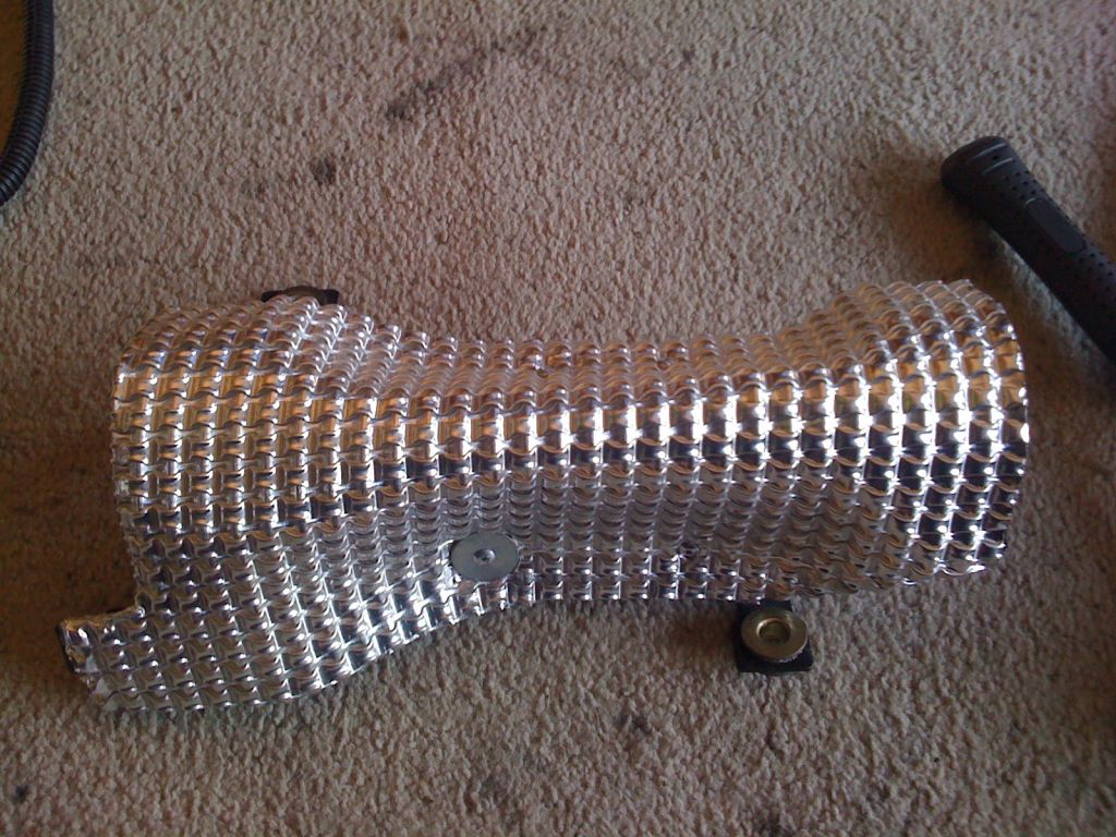

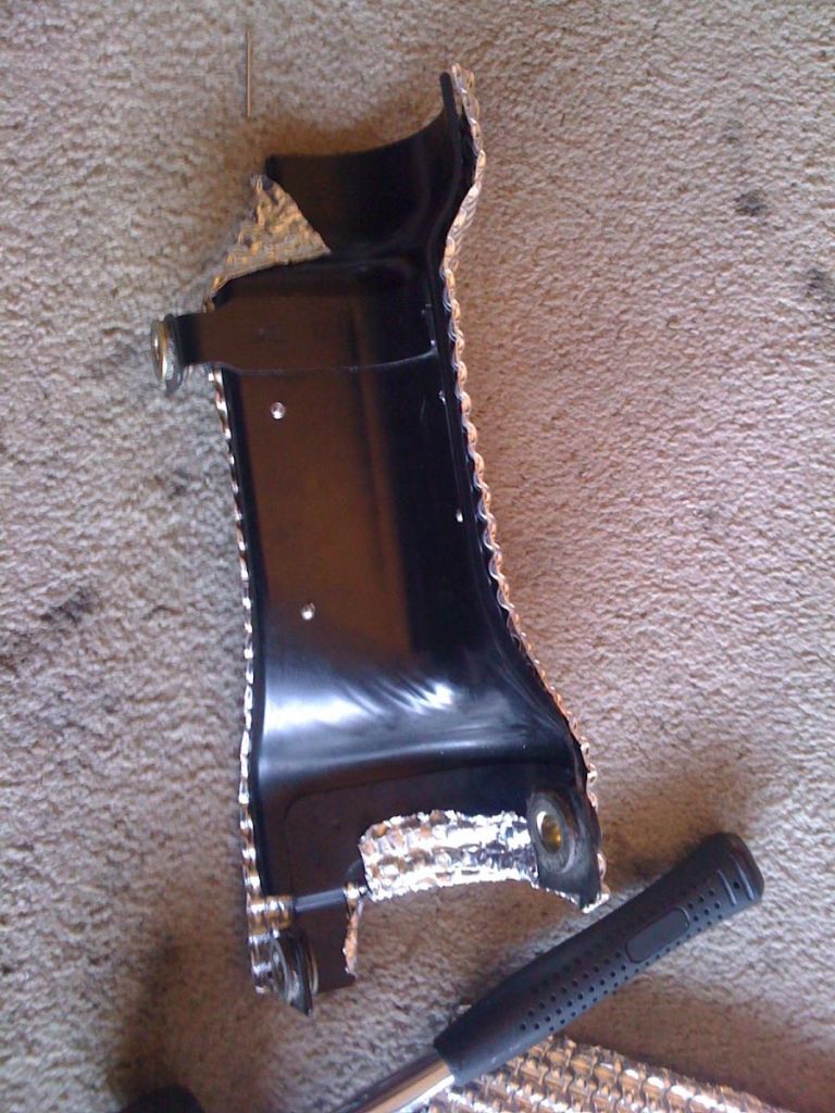

This was quite straight forward. I firstly cut an appropriately sizes piece and then patiently moulded it onto the original shield, following the contours.
I then drilled a series of holes and riveted the Nimbus on to the original shielding.
The finish job turned out okay...
Happy with that. Job done :D
