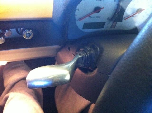

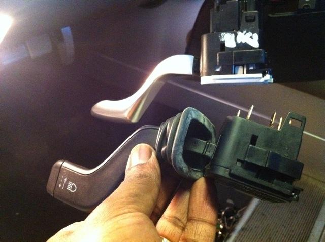

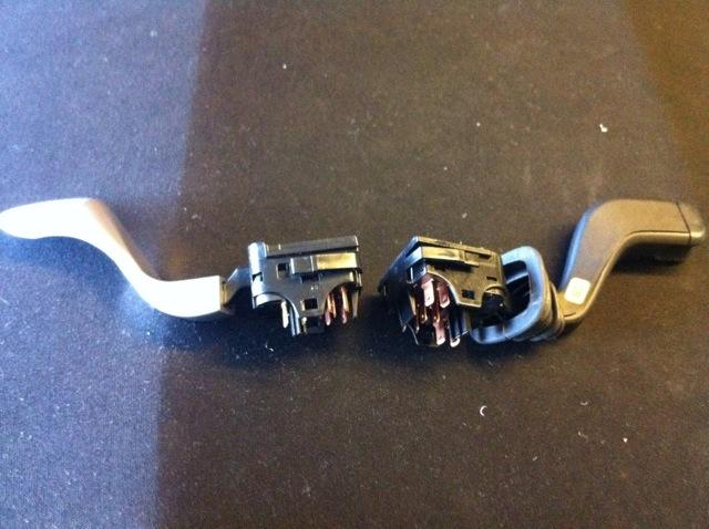

Comparing to the originals, they are very close in terms of size and I think look so much better...
Me like B)

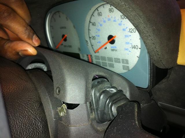

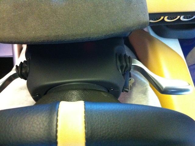

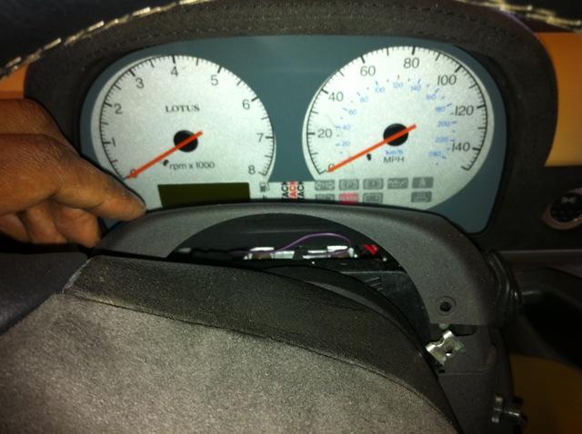

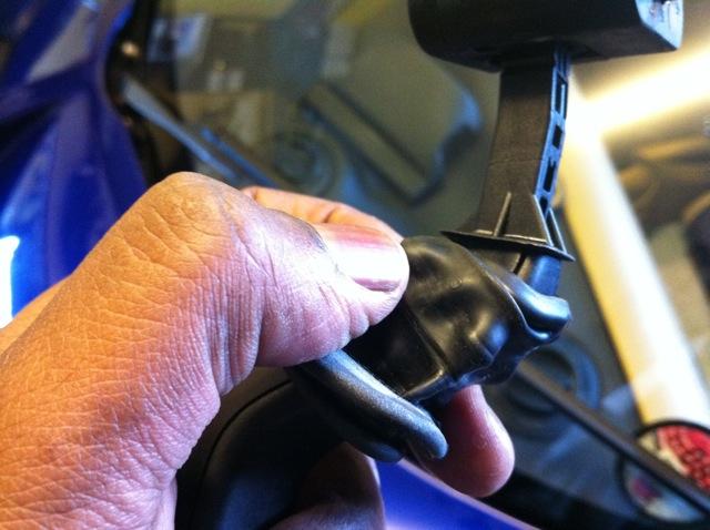

Shroud removal
I am not really sure if this is what its known as, however its removal its pretty easy and took about 5 minutes.
Just remove all the screws that you can see and remove the top half completely off the steering wheel column.
Be gentle as these bits are pretty flimsy.

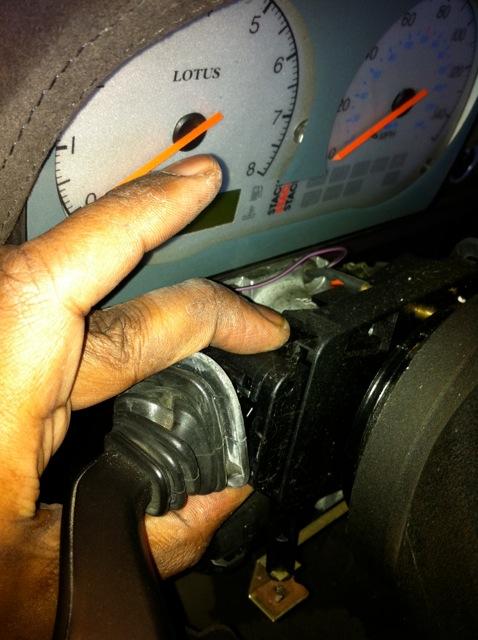

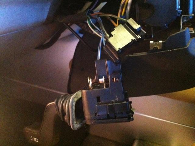

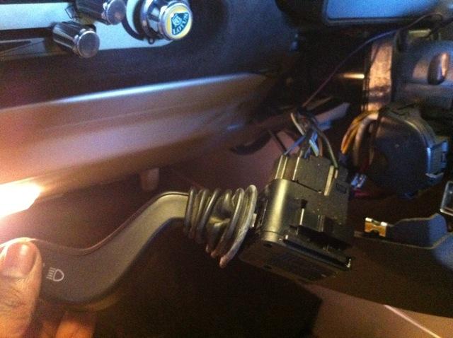

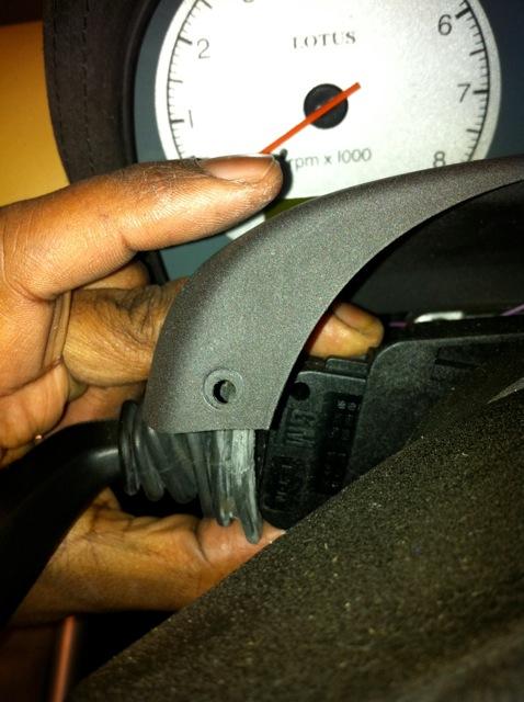

Removal
Once the shroud is clear, gently squeeze the clips at the top and the bottom of the switch, then slide out.
Be careful not to yank the cables as you do this. After all, these cars are not 'young' you know! :D

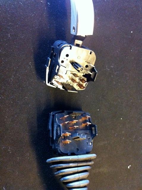

Then, unclip the wires from the switch.
Note: make sure you know where they came from and don't end up in a muddle when it comes to replacing them.

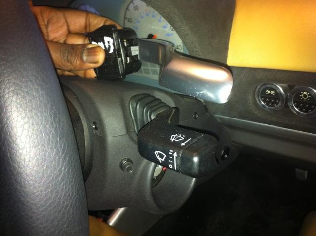

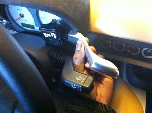

Clip the new one on...
And slide back in place until it clicks in.
Quick comparison photos...
Do the same for the other side.

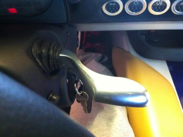

Once done, remove the rubber boot at the bottom of the original stalks and push them through the new ones.

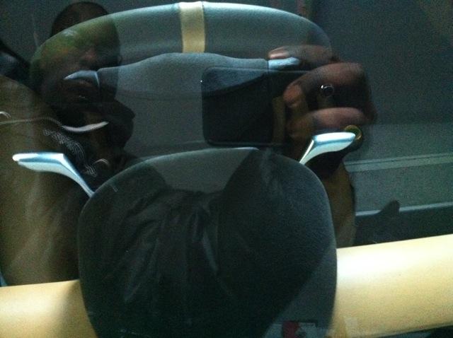

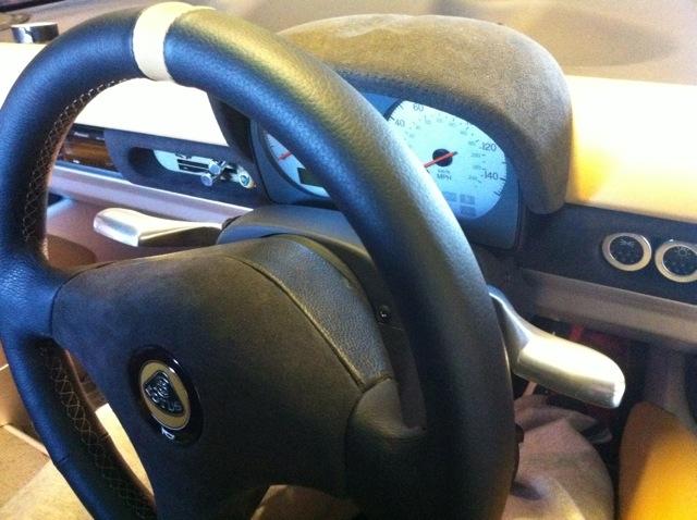

Then, just replace the shroud (reverse of removal) and job is a gooden!!:clap::clap:
I think they look pretty good. The feel somewhat different to the original ones due to the cut out at the back, but apart from that, I am pretty happy.
I can definitely call this job done!!:afro:
